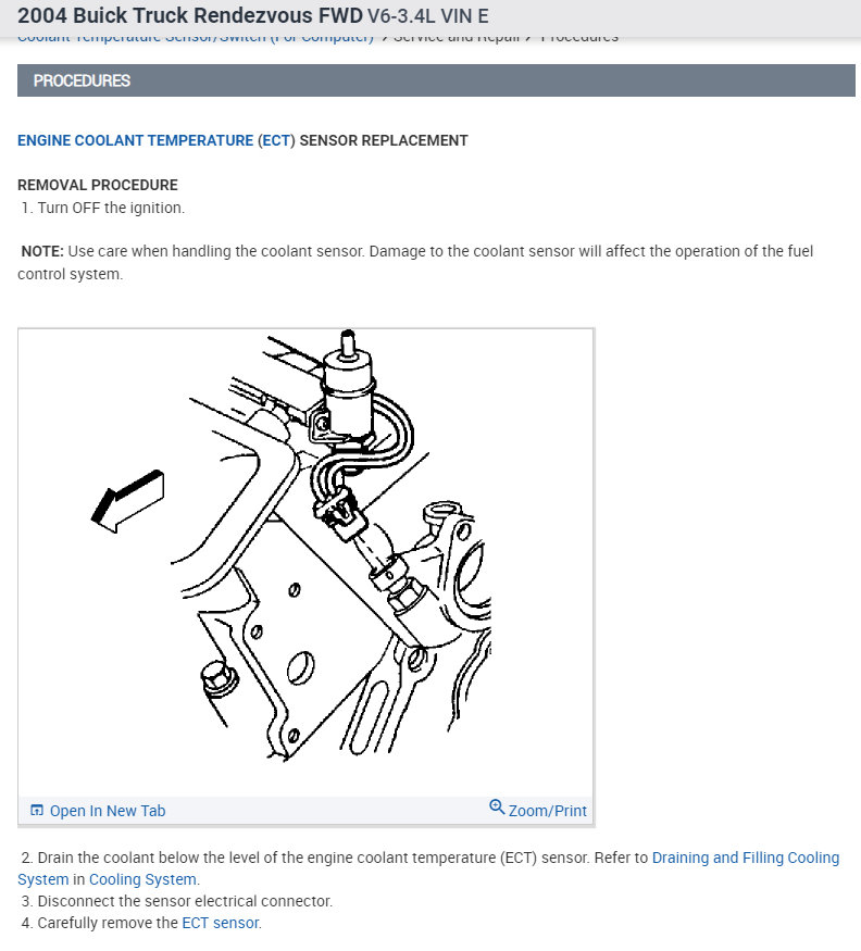

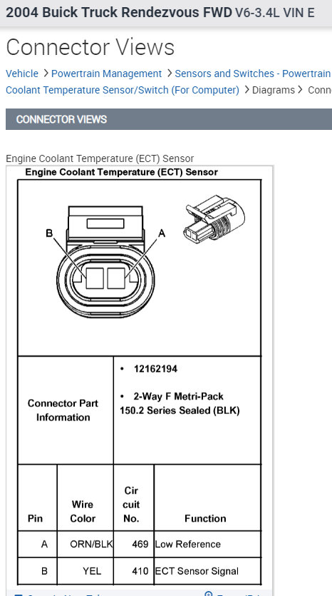

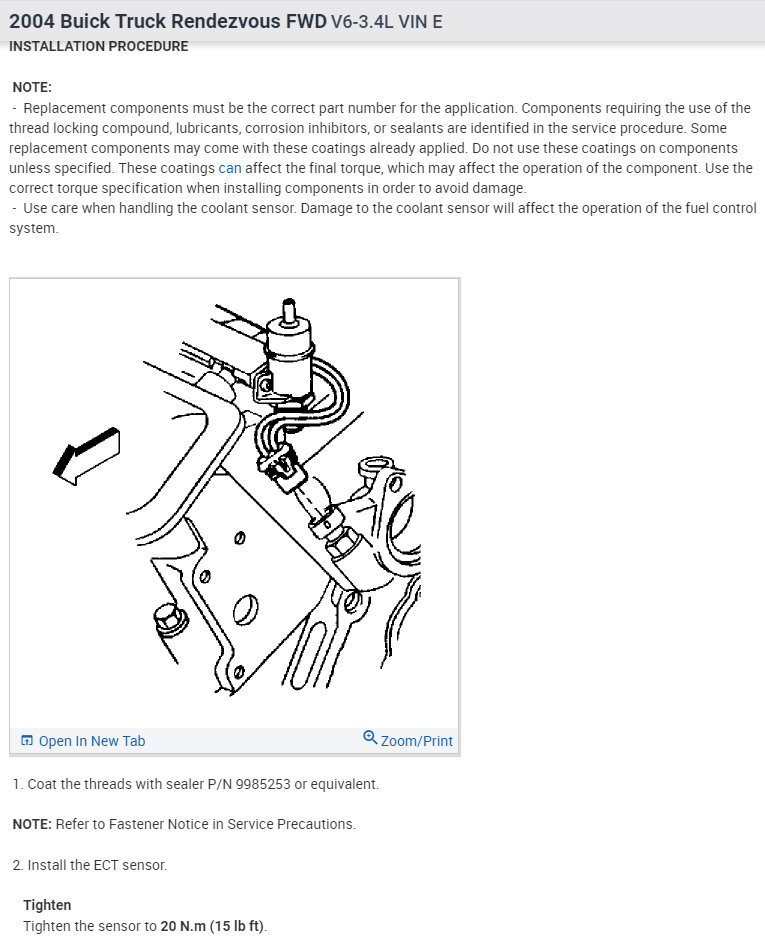

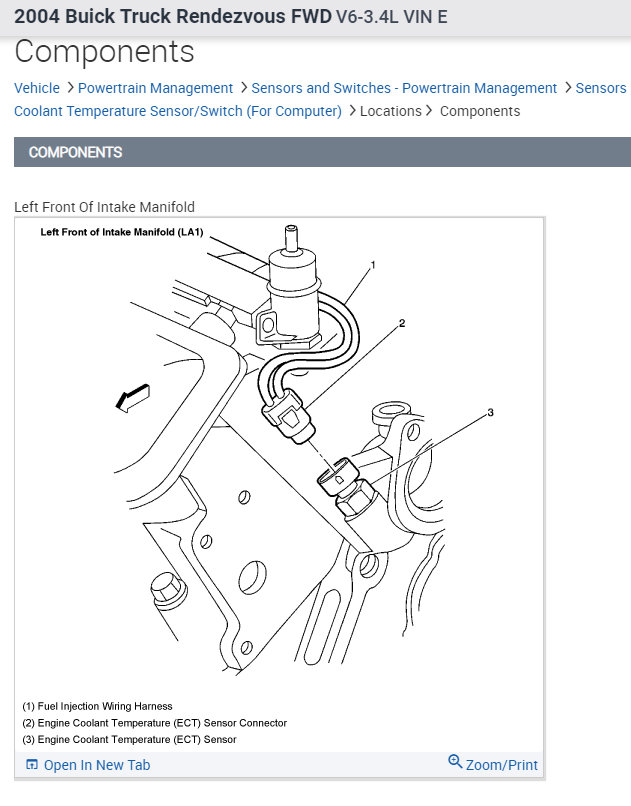

Replacing the coolant temperature sensor but can't locate it. Is it on the right side or left?
Monday, February 7th, 2022 AT 10:36 PM
SQM
MECHANIC
6,383 POSTS
The coolant temperature sensor is located on the front left of the intake manifold.
