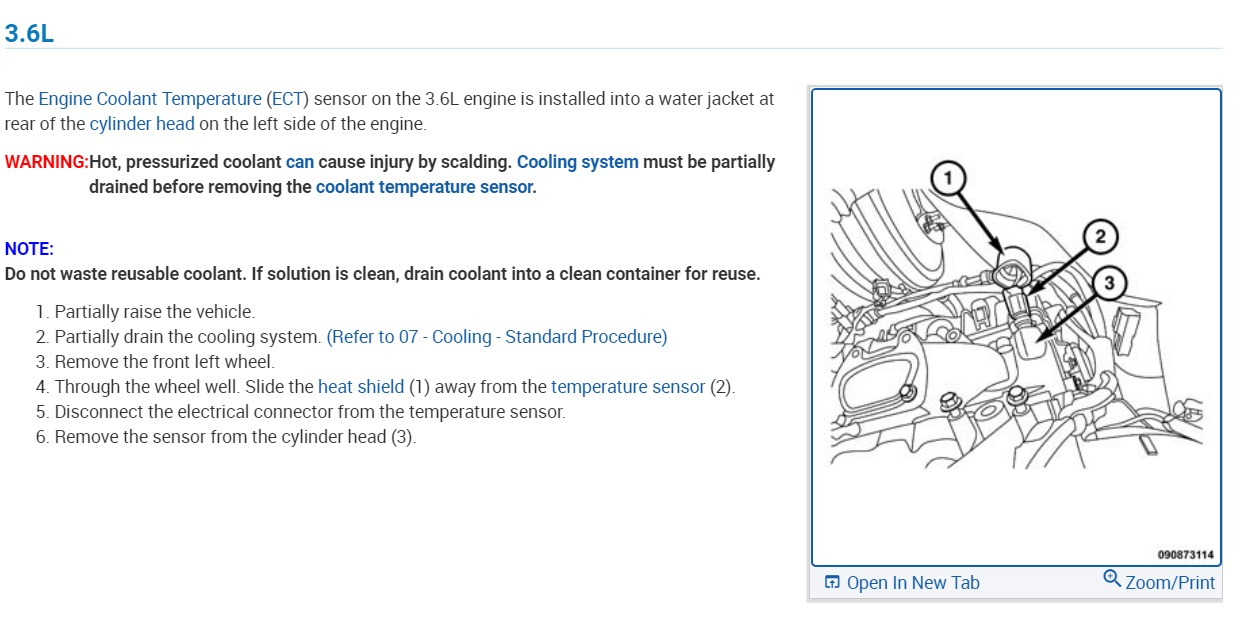

The blue devil is wild stuff, and it can plug things up or coat things internally. I would disassemble the system to remove as much of the blue devil as you can, (you will see it). Please remove the coolant sensor as well to make sure nothing is blocking its ability to read correctly. Here is the location, also replace the thermostat with an OEM unit. Check out the diagrams (below). Please let us know what happens.

Sorry took long to get back to you, I replaced the sensor from a mechanic because it was difficult to get to for me. I put in an oem thermostat and had to put in a new water pump from autozone, the dealer here is back ordered. The Temps are running fine when around town, on the freeway it is going up and down when I have the ac on the coldest setting not max, works fine if I go slightly warmer on the temp setting, one bar above the coldest setting on knob. Really stumped on this and not sure what else to do?
