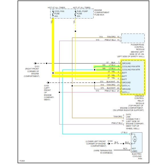

with A/C running radiator fan comes on. without A/C on fan motor refuses to come on. i think the fan motor has two speeds. perhaps one does not work or perhaps sensor is bad. if i jumper both leads going to sensor should the fan come on? will that be an easy test that the sensor or the fan motor is bad? could still be in the wiring ? the fan motor does not default and come on when the sensor is disconnected .
May 24, 2019 at 3:23 AM
Good afternoon,
Yes, try jumping the leads together?
If they come on, then the sensor is bad.
If they do not then there is a wiring issue.
I attached a wire diagram for you to view. Verify the 3 voltages to the unit. If you have all 3 signals, the control is bad. That is a very common failure. It is on top of the fan shroud
May 24, 2019 at 5:18 AM

i clamped a cooking thermometer to the pipe that houses the sensor and ran the engine at idle up to 195 degrees without fan coming on. the car is 23 years old and i am reticent to press my luck to 212 degrees. is there a way to fool the sensor to believe it is 212 degrees? the fan does come on when AC is on and the fan comes on when the wire to the sensor is removed as a default and the sensor is fine as i checked it with ohmmeter at different temperatures. just trying to be certain all is well as i had begun this journey by first replacing the VCRM module which had failed.

Thank you for your time and knowledge and willingness to share both. i bit the bullet and ran the temperature up to 205 when the fan came on. all is good and working. thank you for your patience. kindest regards, respectfully, Mikey.
