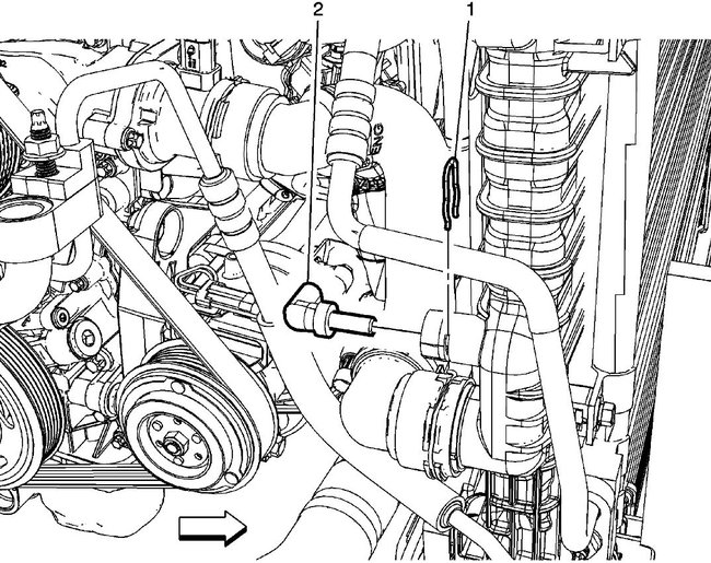

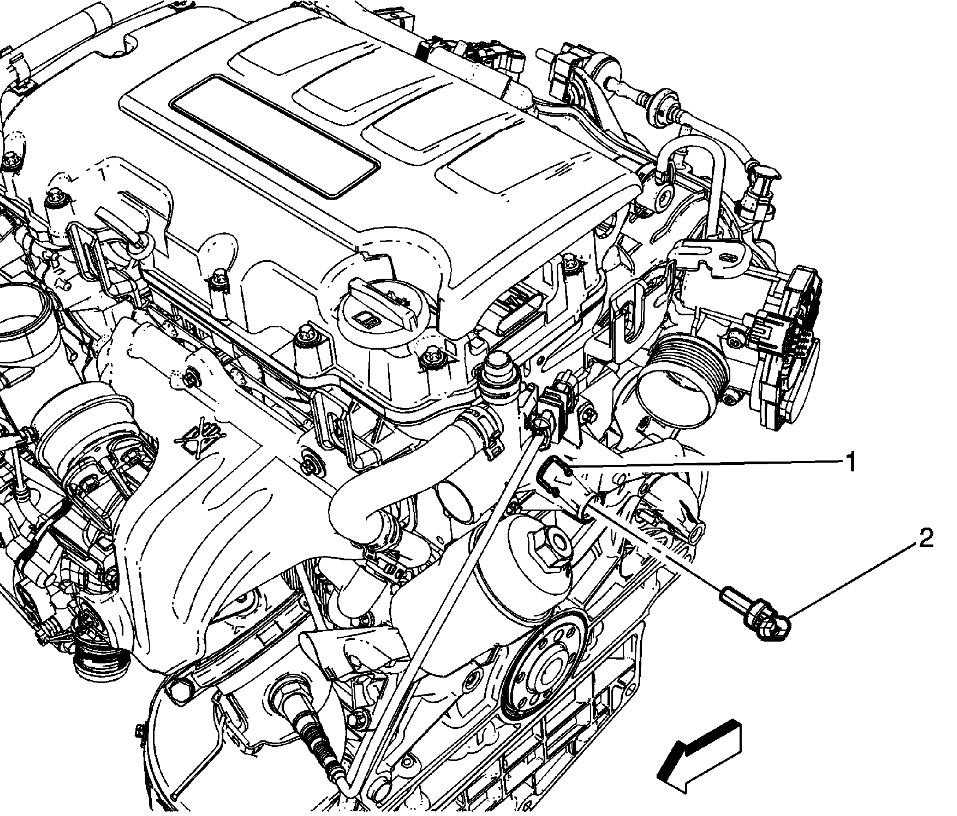

Anyone have a diagram of the coolant temperature sensor location?
Feb 11, 2020 at 9:31 AM
STEVE W.
  • 15,404 POSTS
There are two different coolant temperature sensors on that vehicle. One is on the bottom right side of the radiator in the first pic item 2. The other is on the rear of the engine as in the second pic item 1.
What is the issue you are having?
