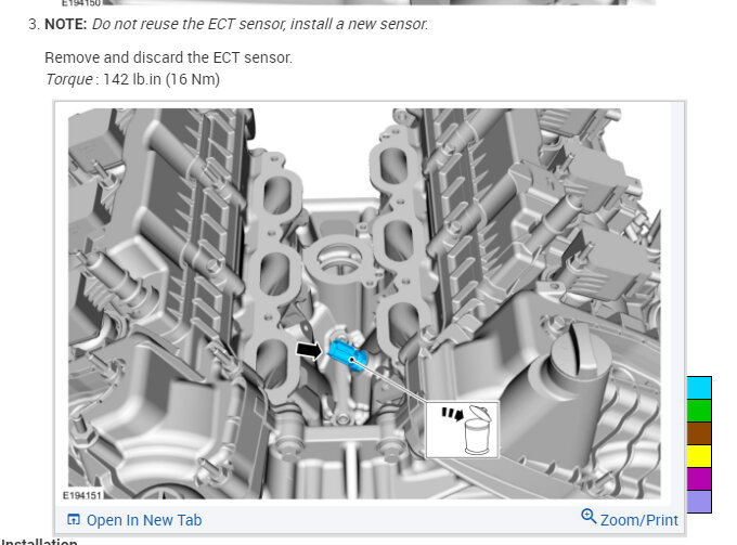

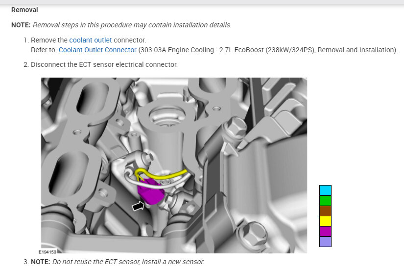

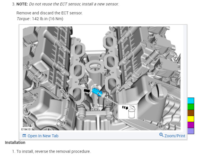

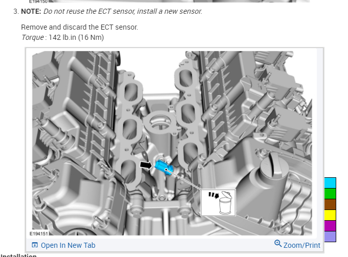

Where is the Coolant Temperature Sensor located?
2018 FORD F-150
55,000 MILES • 2.7L • 6 CYL • TURBO • 4WD • AUTOMATIC
TLKROUT
Location?
Feb 5, 2023 at 5:50 AM
  • 110,241 POSTS

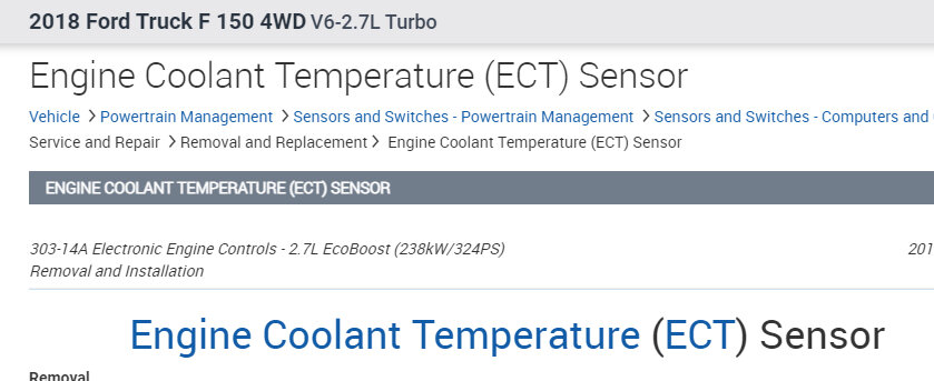

The engine coolant temperature sensor is located under the intake manifold. The intake needs to be removed to access the sensor.
I attached the directions below.
