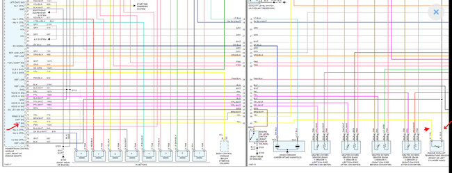

I had to replace a gasket for my exhaust manifold and unplugged my coolant temperature sensor sensor and after I was finished I plugged it back in. I turned the ignition on and the coolant temp gauge was reading maxed out even tho the truck was cold. I unplugged the sensor and same reading on the gauge. Truck is throwing a p1258 overheating code and dash is saying limp mode overheating. I inspected the wires all the way to the y and they look good. I replaced the sensor and nothing changed.

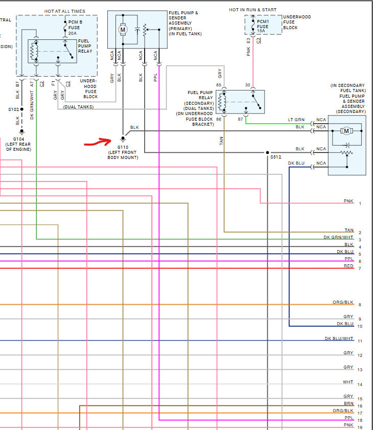

Yep, something must have got pulled on the wiring you are going to have to test the wiring from the sensor to the PCM. Here is a guide and the wiring diagrams so you can run the test. Also, check the engine harness grounds, if one of the grounds is off it will cause this problem.
Check out the images (below). Let us know how it goes
