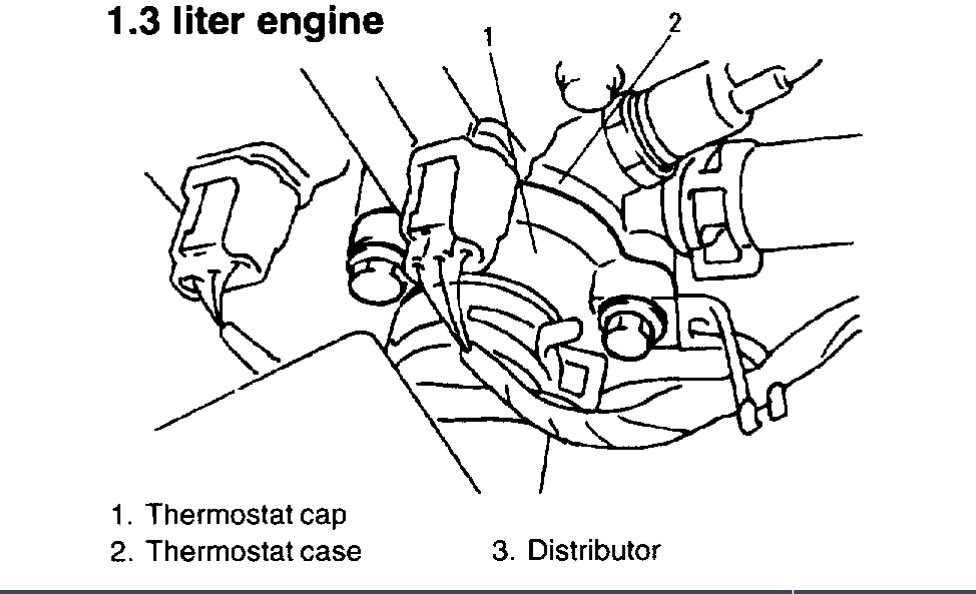

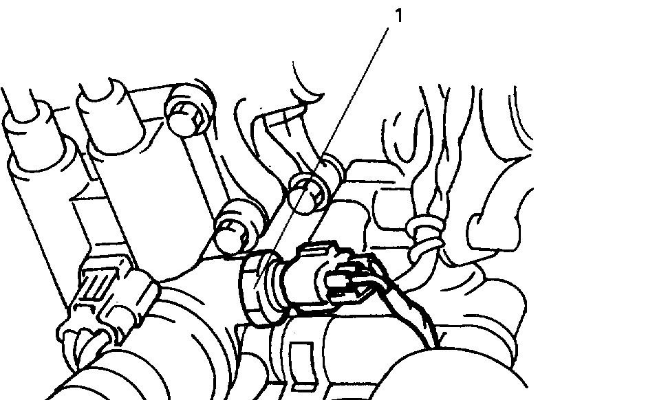

temperature gauge increasing max but engine is running correctly and not overheating. Sensor is 3 pin type and has just been changed as original failed on engine management side.
Gauge was operating correctly.

Did you change the thermostat?

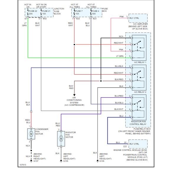

I also attached a wiring diagram of the cooling fans. Are they working when the engine gets hot?
Jul 2, 2020 at 5:27 AM
JIMNY99
Engine is not running hot. No loss of water. No other signs of overheating. Gauge was not showing high temperature before sensor was changed. Sensor is a dual type and the original was not sending correct signal to ECU. New sensor shows gauge at normal temperature when cold in morning. No other changes to the engine. I suspect incorrect sensor supplied. Engine is now running smoothly, no engine light.

Sensor is a 2 element type. The element going to the ECU was faulty giving an engine fault light. Fault codes were checked and the sensor diagnosed as faulty. So there was a fault on 1 element of the sensor but not on the element for the temperature gauge.
