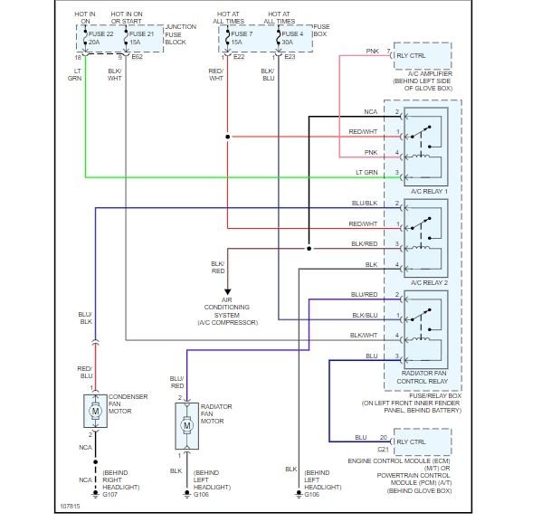

I also attached a wiring diagram of the cooling fans. Are they working when the engine gets hot?
Jul 2, 2020 at 12:27 PM
