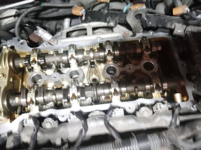

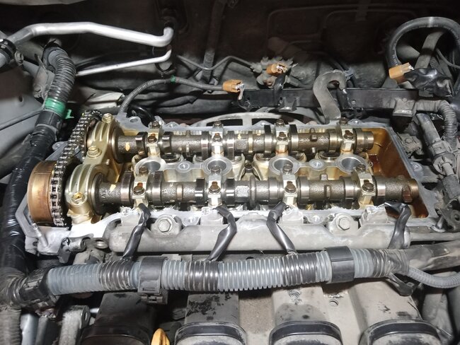

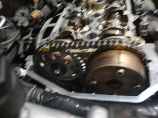

yes, it will be mountains, and it will be a long trip. I just replaced the timing chain. That is why I was worried about the temperature. I thought I did something wrong that made the car " overheat". The old chain was not stretched. The exhaust sprocket and the crank sprocket were like new. The only problem I found is the chain guides have deep grooves. these are some pics.
