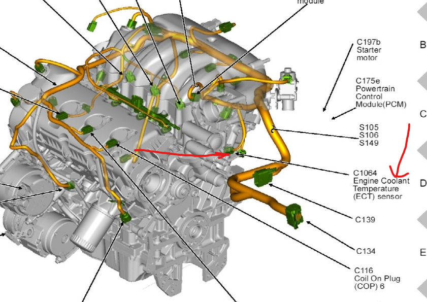

Where is my coolant temperature sensor located on this engine?

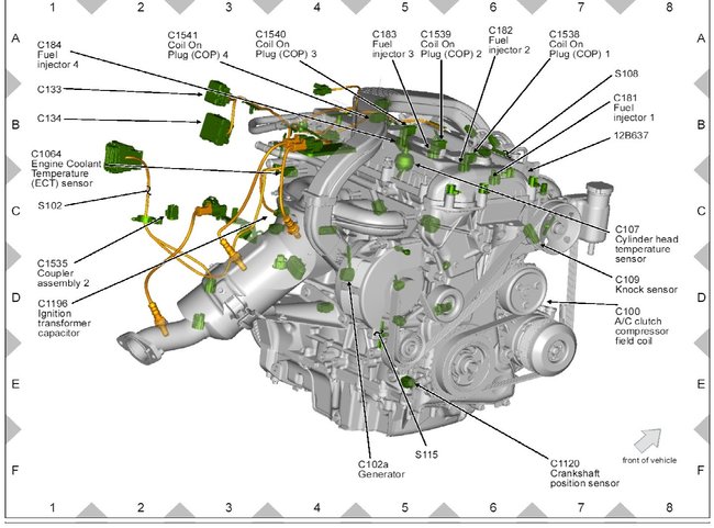

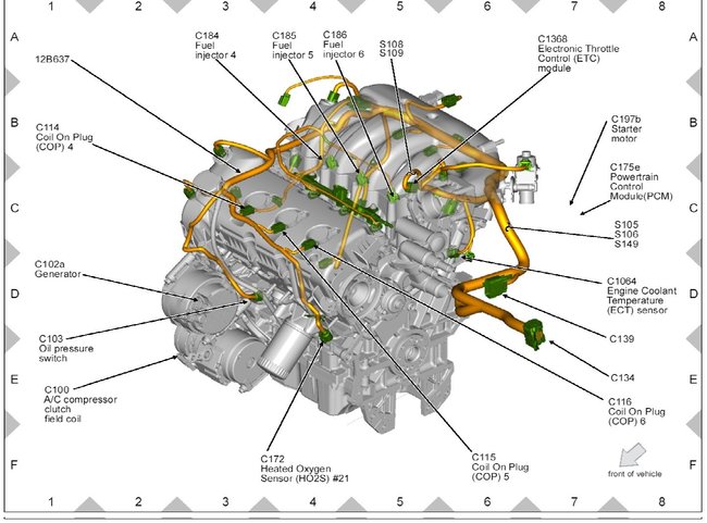

Hopefully the images will guide you in the right direction. If you would have further question feel free to ask thank you and have a nice day.
