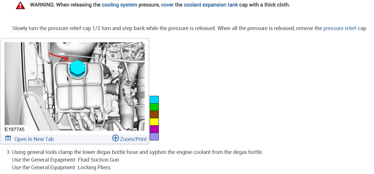

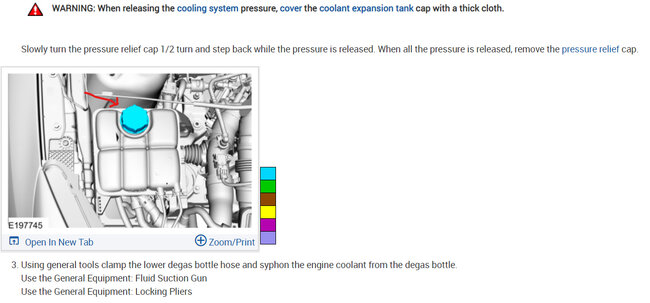

If coolant is getting pushed out of the cooling system without the engine overheating, I would check for a blown head gasket. Also, if the radiator cap is bad, it will not allow pressure to flow and will blow the radiator tanks out. Here is a guide to help you check for the blown head gasket and you can get a new radiator cap from Amazon.

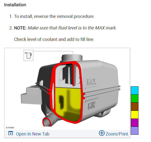

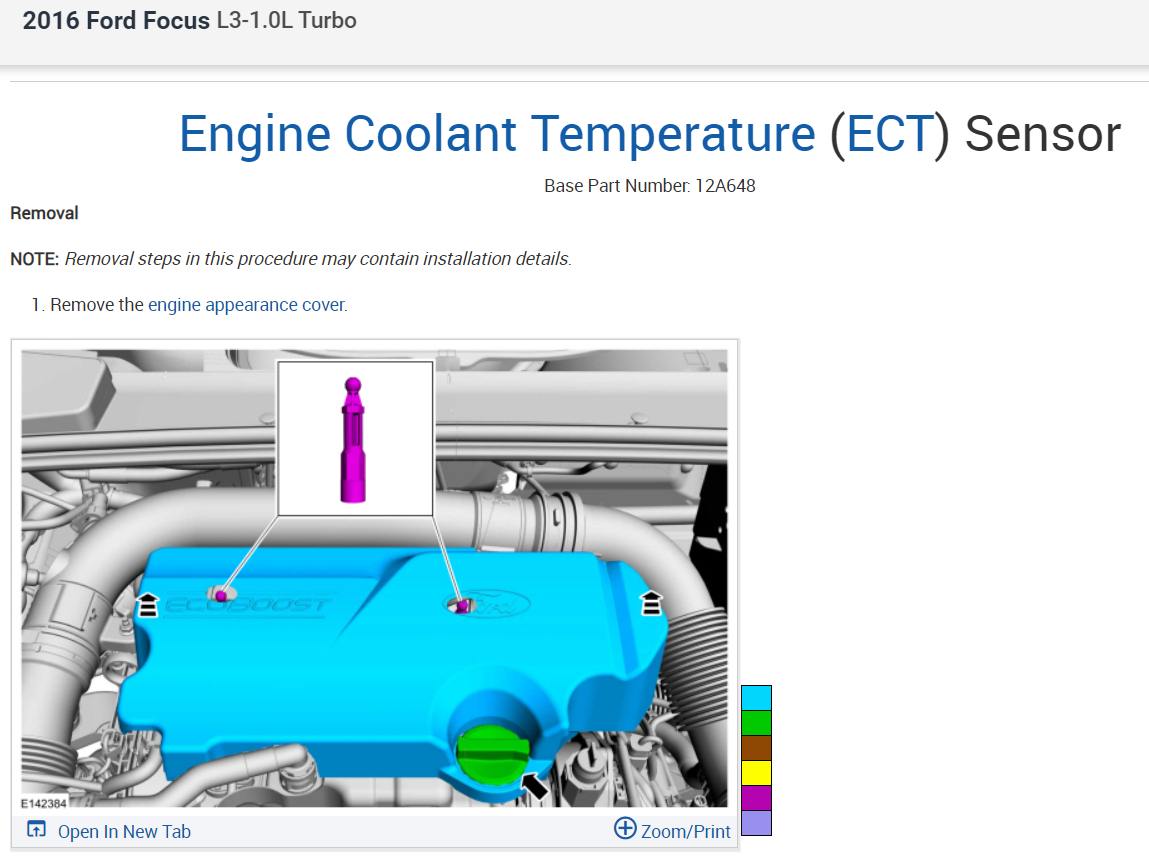

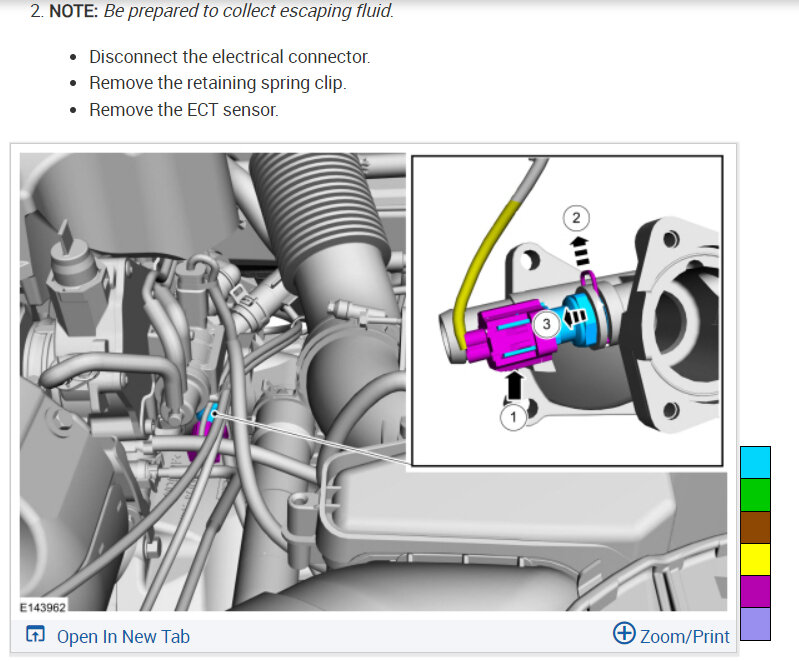

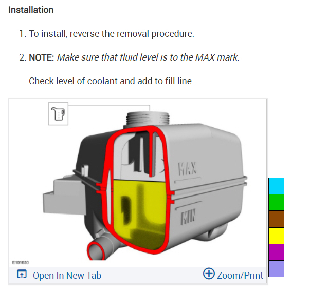

So if the coolant sensor says it is not overheating can I ask if the cooling fan is running when the engine is hot? If not this will be the problem. If the sensor says the engine is not hot the fans will not come on, here is the location of the coolant sensor so you can change it out. Please go over this guide as well:
https://www.2carpros.com/articles/engine-overheating-or-running-hot
Make sure the engine is cold before you change the sensor out. Check out the images (below). Please let us know what happens. You may still have a blown head gasket because coolant is not in the oil 100% of the time FYI when this happens.
