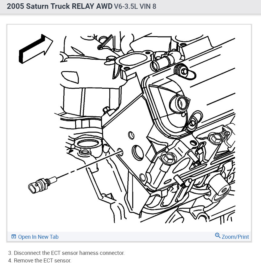

Hi Jimmy,
It sounds like the engine coolant temperature sensor needs to be changed. Here is a guide to help you through the steps and diagrams below so you can see how to replace the sensor on your car:
https://www.2carpros.com/articles/coolant-temperature-sensor-cts-replacement
The sensor is down low on the cylinder head near the rear of the engine.
