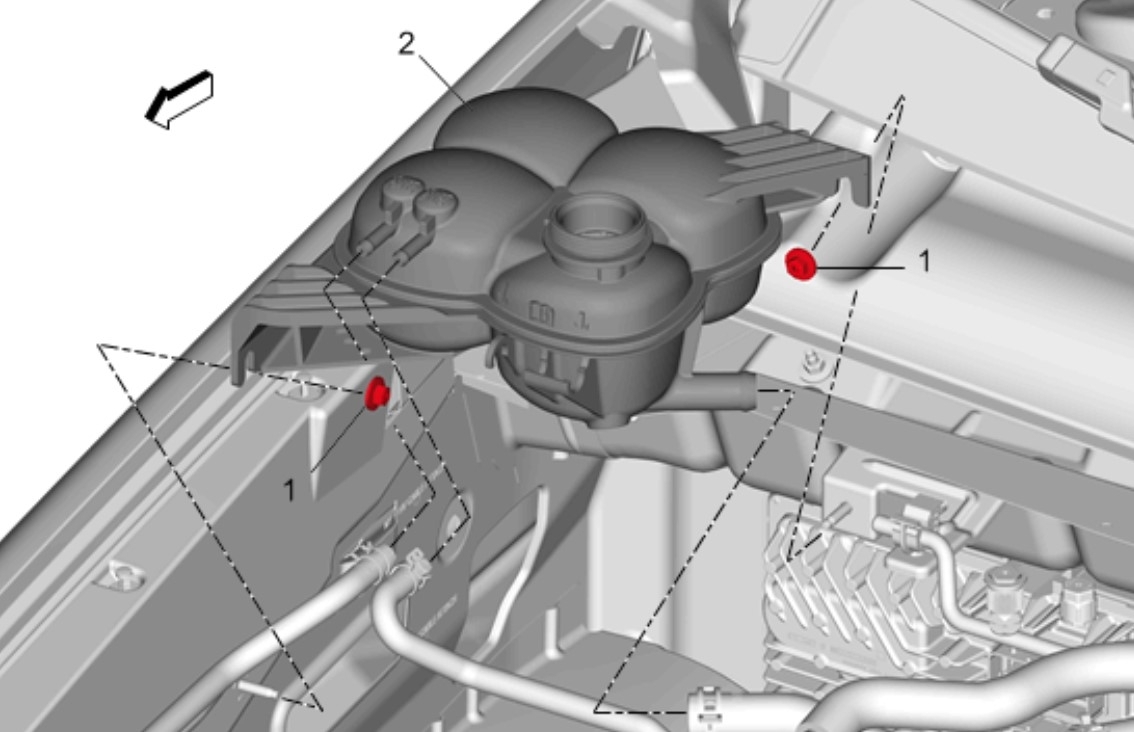

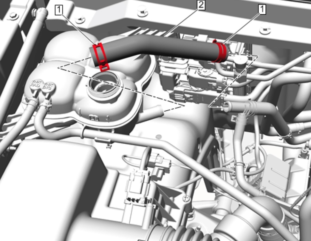

with a rented pressure tool kit i have no pressure at the overflow bottle, it seems like a hole at the very bottom.
is almost made that way is where the leak is
plugging it with finger i get some pressure but very little.
isn't the system supposed to hold pressure?
Apr 11, 2025 at 9:28 AM
STEVE W.
  • 15,410 POSTS
The overflow bottle is a two-compartment item. There is the pressure side of it that has the cap, then there is an area where the cap screws in that have a vent. What is supposed to happen is that under normal use the coolant can expand and contract in the surge tank. It holds the pressure at 13 psi to prevent it from boiling. If it is properly filled it should only go from cold to hot and back. However, if it gets too hot the coolant may expand farther than normal and exceed the 13-PSI rating of the cap. That will force coolant out through the pressure cap and out a vent on the bottle, so it is controlled. I suspect that the tester you have either has the wrong adapter and isn't sealing properly or it is damaged. Sadly, that is a common thing with rental tools.
