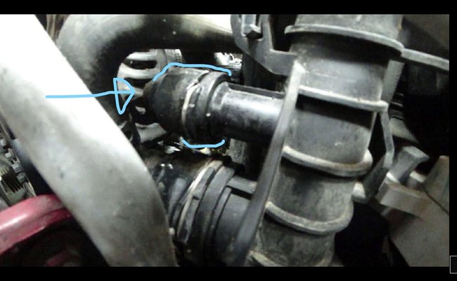

This connector leaks coolant, car remains on H engine overheat warning even if sitting overnight! I am hoping to find out what is the name of the part I need to replace. It is the top L shape connector in this image. Also, will this correct my high temperature warning or will I have to replace a sensor? If so what sensor? Thanks
When coolant is added it pretty much flows right out the back of that L shape connector. Goes to a smaller hose!

BRUCE CHARTRAND
Here you go. It would not upload with the original post.

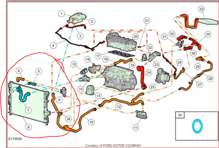

Hello again.
I have attached a picture and believe it is #5 or #6 and circled in red (hard to tell from your picture). I believe it is #5. They are called the "Transmission Fluid Cooler Coolant Control Valve Inlet Hoses". Hope this this helps and ask any other questions if needed. Thanks again for using 2CarPros.
Danny-
Sep 16, 2018 at 4:23 PM
BRUCE CHARTRAND
Definitely in the place of #6. Thanks a lot!
