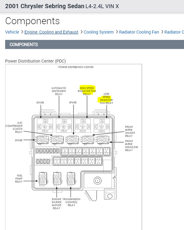

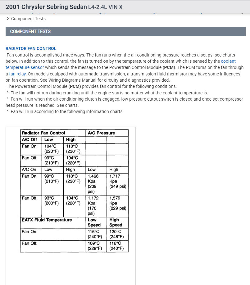

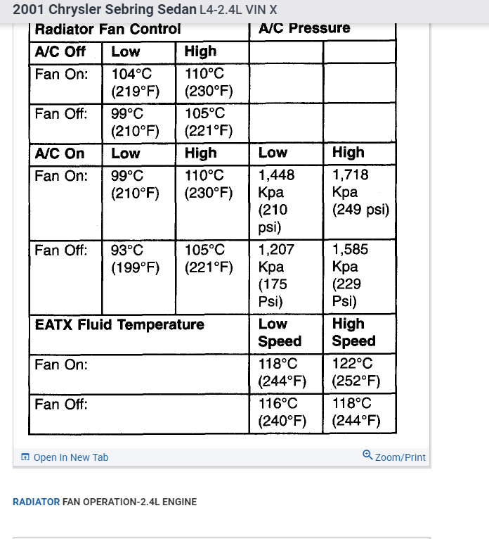

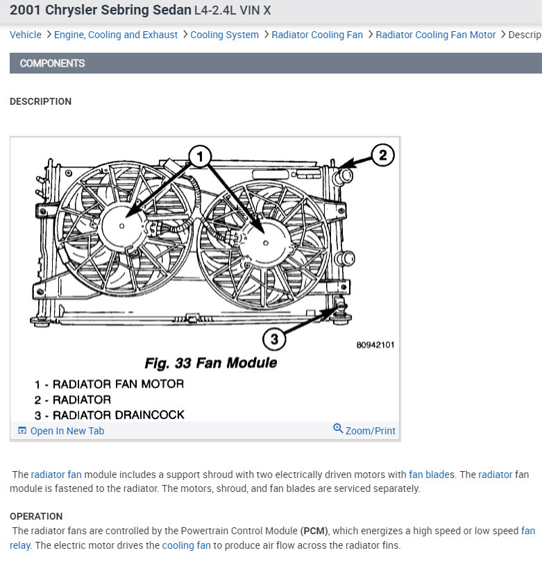

It sounds like you might have an issue with the cooling fans.
If the fan is not working, it will not have any air flow through the radiator while you are at a stop and that will make the engine overheat. But as you move the air flows through the radiator and cools it back down to normal range.
Do you know if the radiator cooling fans are coming on?
With the engine running at the operating temperature the fans should turn on.
In operative fans can be due to a faulty relay, bad fan motor, coolant temperature sensor or issues with wiring.
https://www.2carpros.com/articles/how-an-electric-cooling-fan-works
