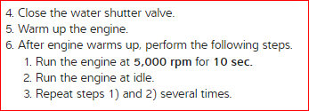

I drained my coolant system pulled drain plug on radiator to change my thermostat. I filled up my coolant reservoir and the radiator is not sucking up the coolant and the system is not burping and there is no cap on the radiator. So I could use all the help I can get. Thanks, Matt

Hello, I am Danny.

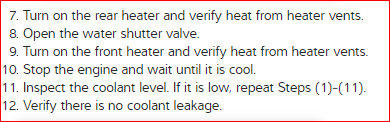

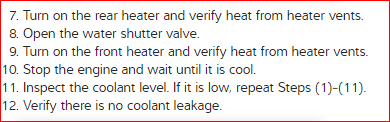

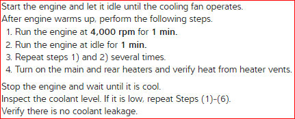

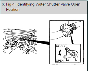

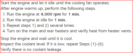

Does you vehicle have a rear heater system? I found this that might help. I have attached a few how-to steps and a picture of the shuttle valve as well. Here are tips for both types. Hope this helps. Feel free to ask any further questions and thanks for using 2CarPros. Danny-
