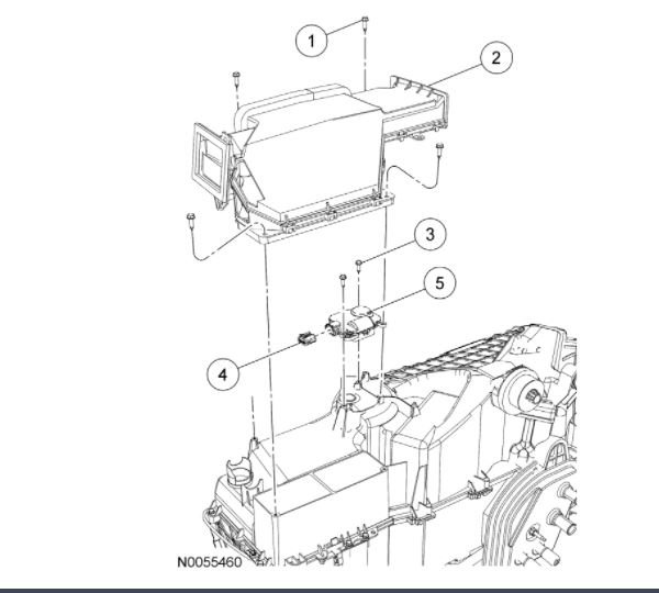

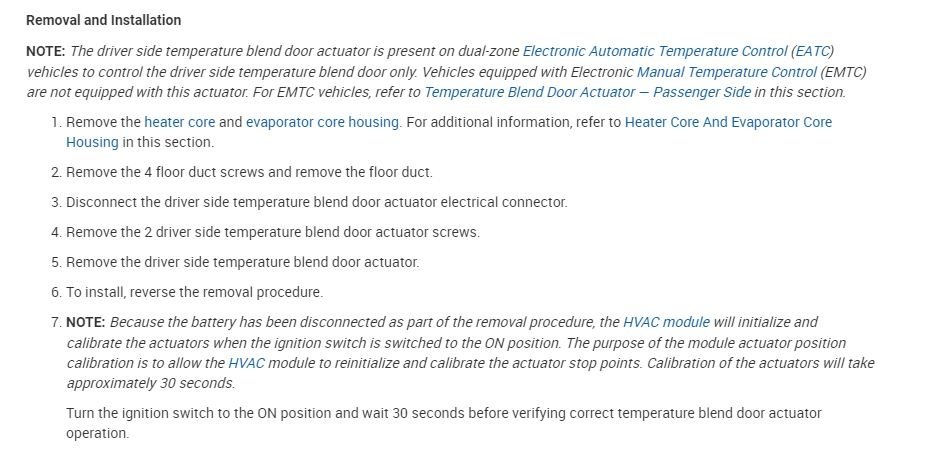

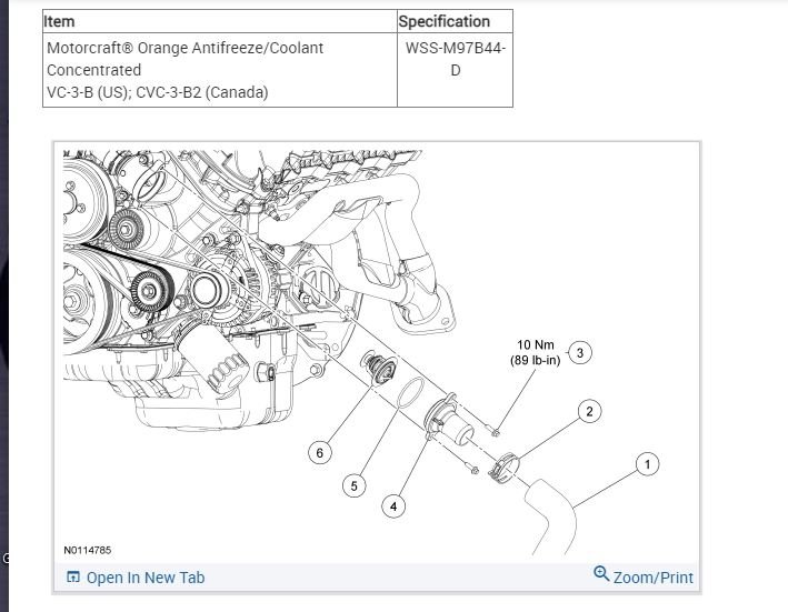

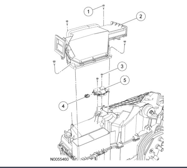

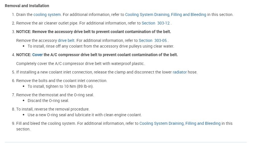

Good afternoon,
Besides making sure the coolant level is correct, I would also make sure there is heat when the level is full.
If it is, then you need to find the leak and then repair it.
https://www.2carpros.com/articles/car-is-leaking-coolant
If it does not, then you need to check the thermostat and the blend door motor for proper operation.
