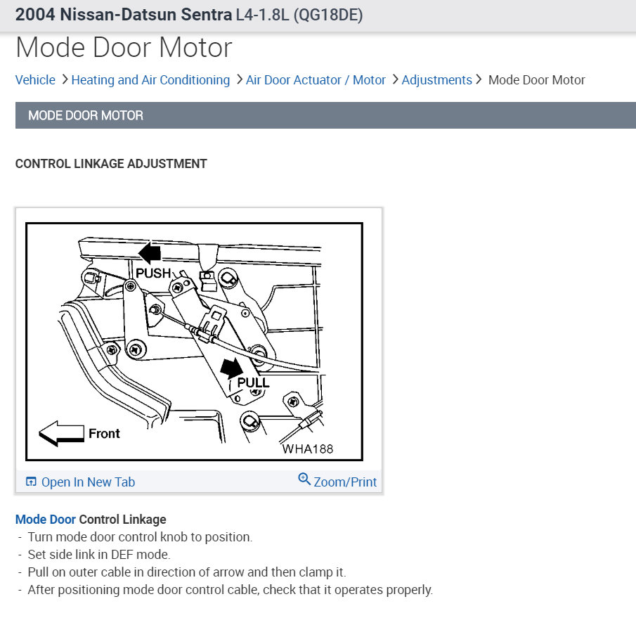

When I drive down the road hot air blows from vents even when AC/heater is off. Also AC does not blow cold. Car is hard to crank.

For the cranking issue please start a new question. Please post your new question here, you must be logged in.
It sounds like the mode blend door actuator is not working, or the control cable is disconnected. Here is a diagrams below to show you what to look for.
