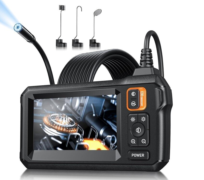

It's very possible for it to be a minute leak in the neater core. That would lead to a smell only when the heat is on, and the air goes through the core. It would also make it very hard to find unless you used a camera to go into the HVAC case to look at the core itself. Coolant only takes a minor amount to create a nasty odor and if it gets hot it smells burnt.
I would get an endoscope and run it into the core and look for any deposits from coolant. You can get a scope like the attached that would work okay from places like Amazon. Then you just feed it into the dash vent and into the case.
