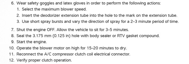

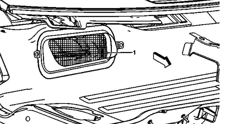

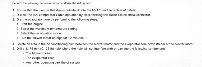

don't worry about the ac, check to see if drain is plugged by running a wire through the bottom of thedrain hose under car it will be by firewall in center you can also check for debris in front of windshield and turn blower on shoot something like febreze into screen in pic with blower on high or follow the directions in the other two pics
