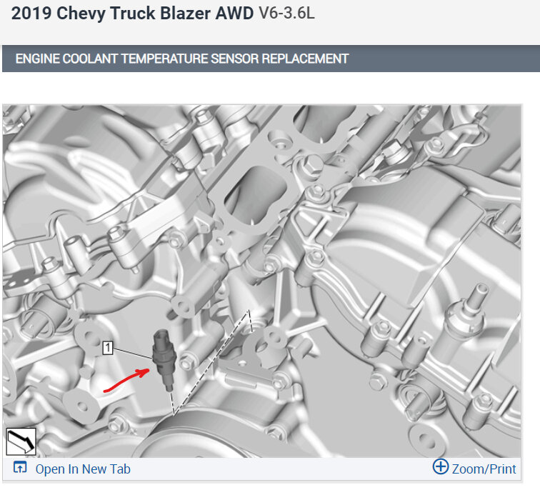

Can anyone tell me where I can’t find the engine coolant sensor location.

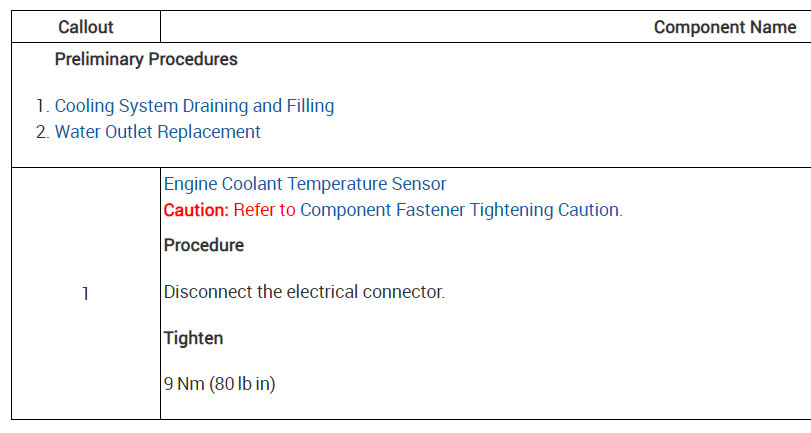

Some sensors are easy to find, this coolant temperature sensor under the intake towards the front of the engine between the cylinder heads. Check out the images (below). Let us know if you need anything else.
