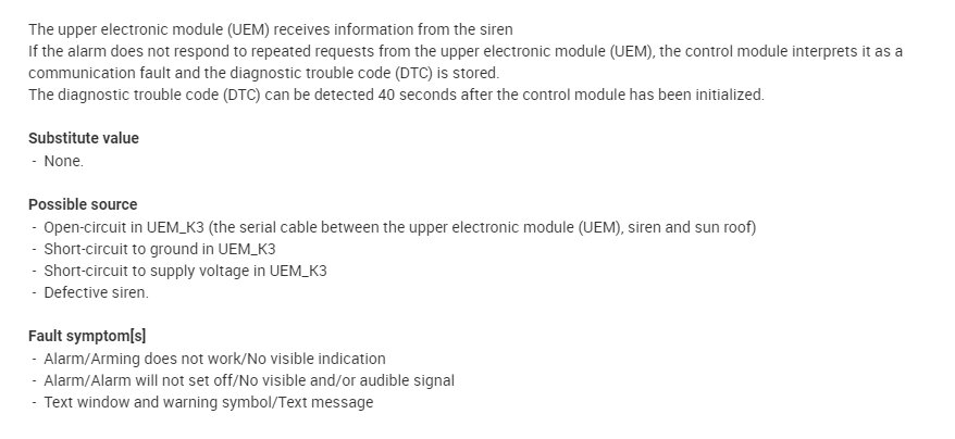

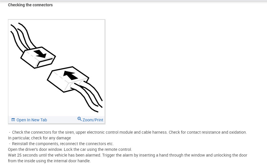

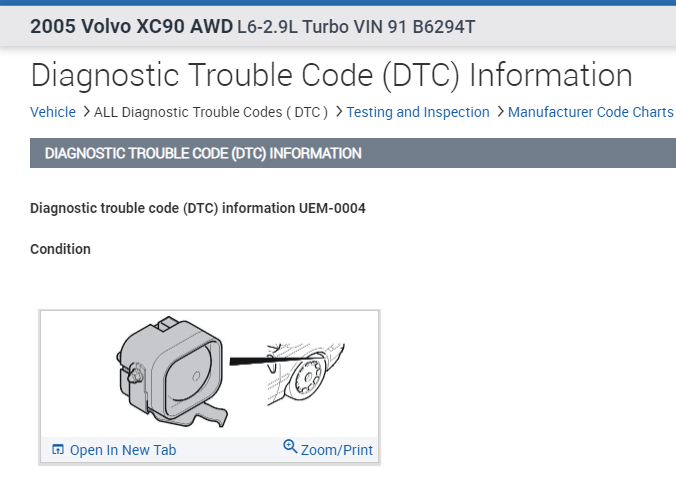

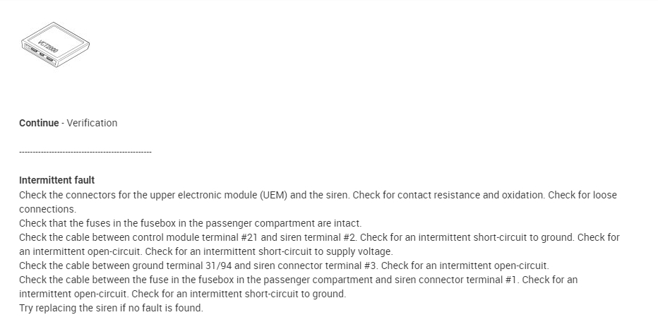

I replaced the coolant level sensor installed. It a brand new but still has the message low coolant level. and the alarm siren replaced the same thing saying alarm service is required.
please help me to get rid of this situation I used my scanner to delete I but still having the problem.
Jan 31, 2023 at 11:48 PM
  • 110,240 POSTS
Chances are you have a wiring issue or there is a problem with the connectors. By chance, could you provide me with the codes you are getting? That will help point me in the right direction for diagnostics.
Feb 1, 2023 at 11:09 AM
VICTORY76
  • 27 POSTS

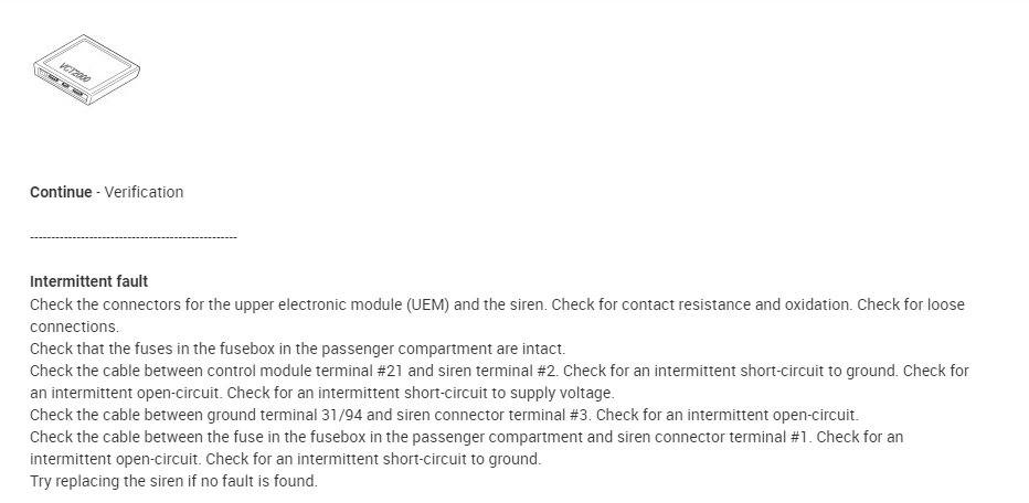

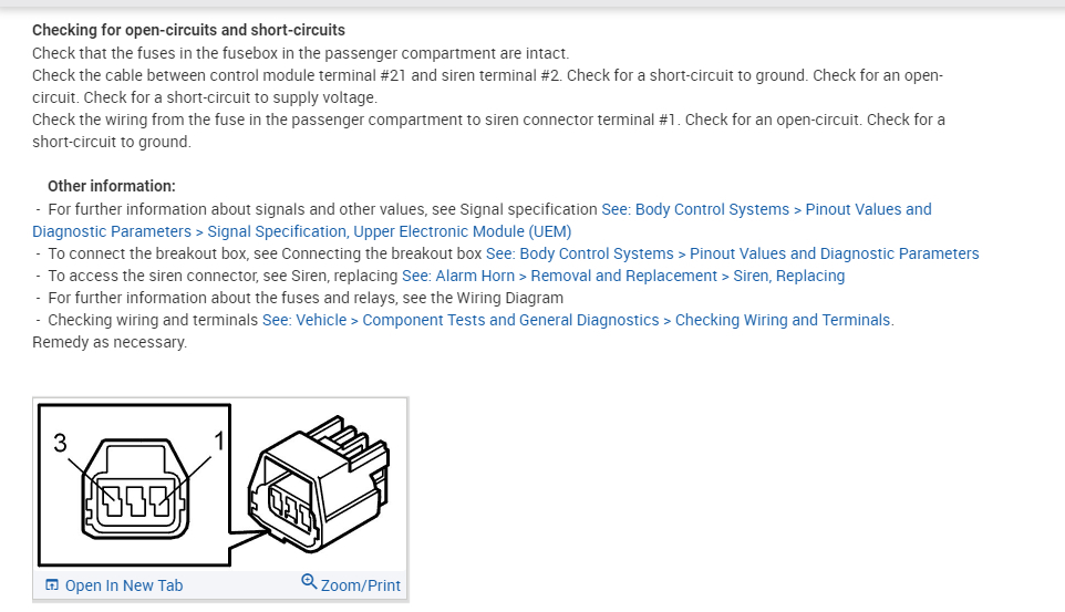

Thanks for your help, UEM- 0004 siren communication fault. but no code for coolant level just appears on messages window.
Feb 1, 2023 at 9:20 PM
  • 110,240 POSTS

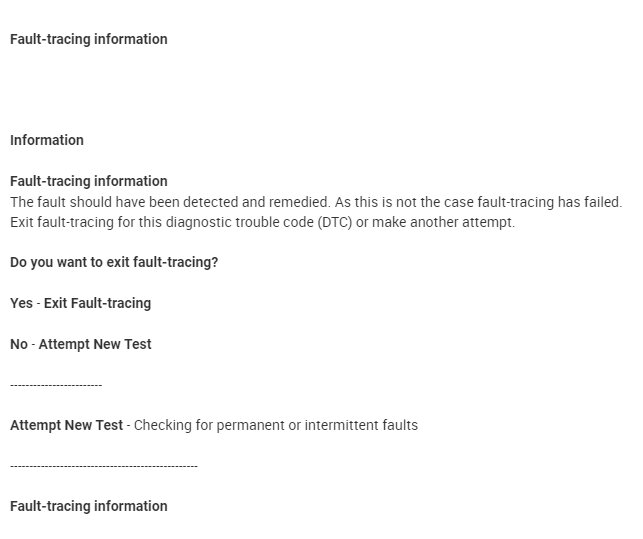

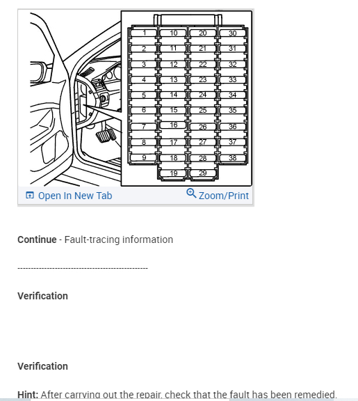

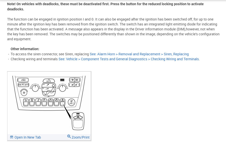

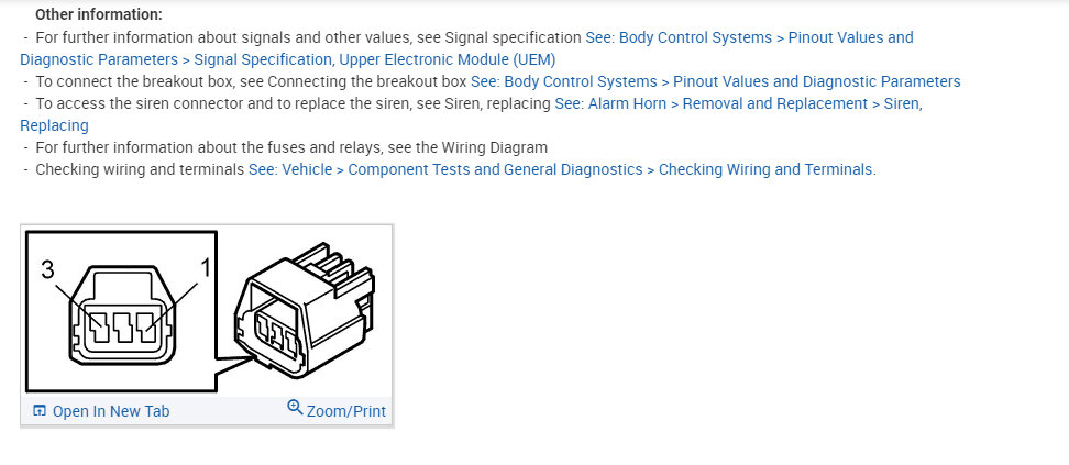

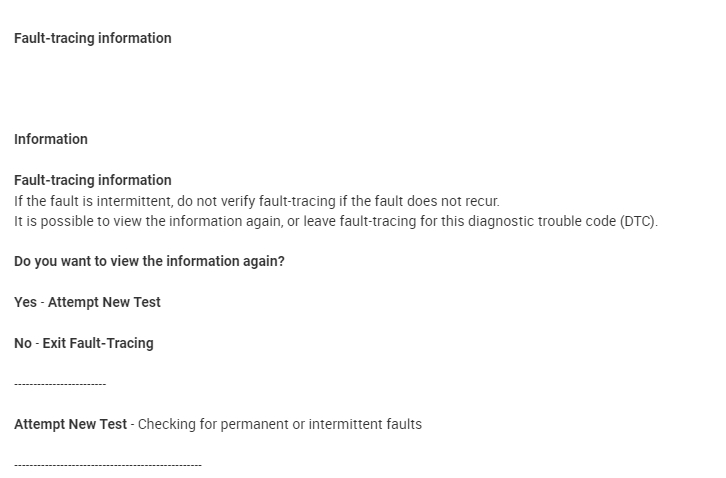

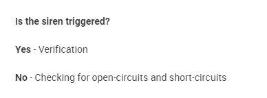

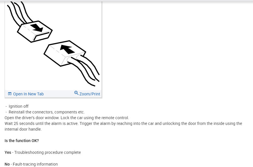

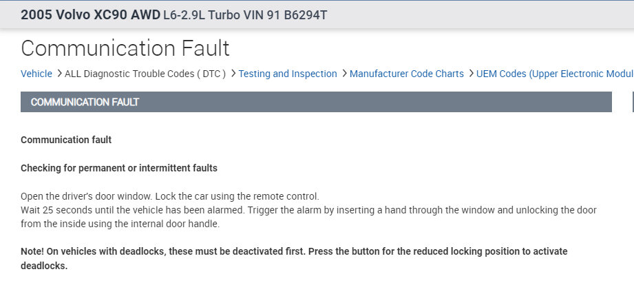

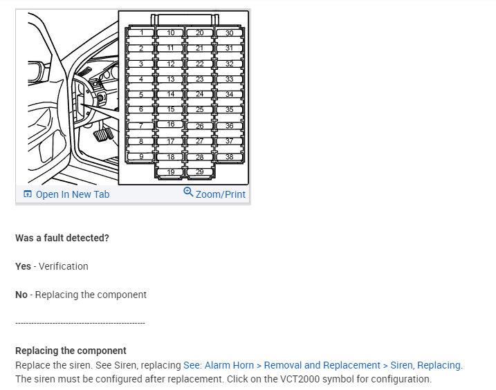

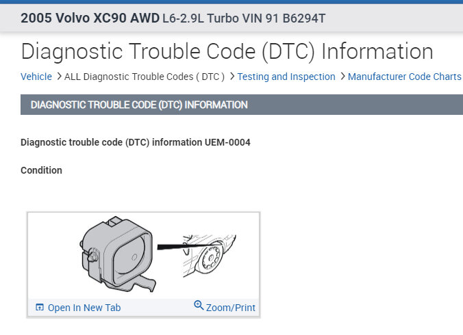

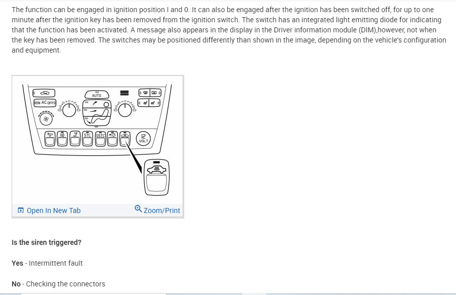

As far as the code is concerned, it is related to the upper electronic module (UEM). I attached a description below (pics 1 and 2).

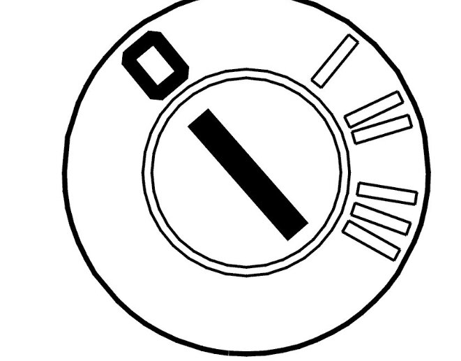

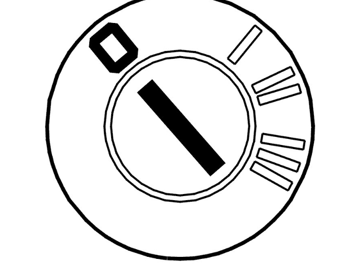

The remaining pics are the diagnostics related to the UEM code. Take a look through them and let me know if you are comfortable performing them.
As far as the level sensor, did you check the connector for damage such as corrosion, a damaged connector pin, or a broken wire? With the key, disconnect the sensor and see if you have power to one of the terminals.
Let me know what you find.
