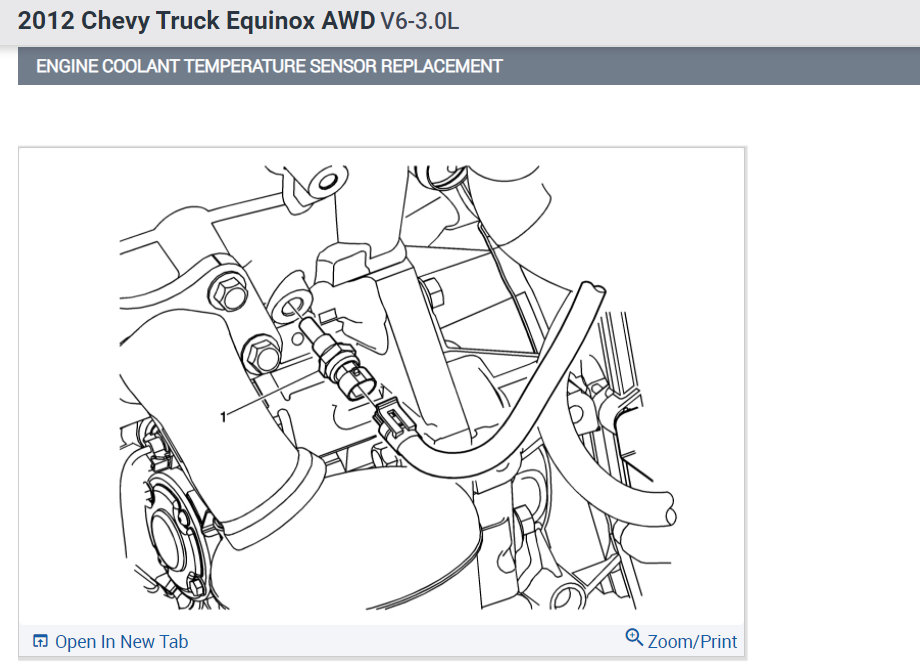

I’ve had the coolant sensor just quit working can you help me find it any ideas?
Jan 14, 2020 at 5:17 AM
CARADIODOC
  • 34,381 POSTS

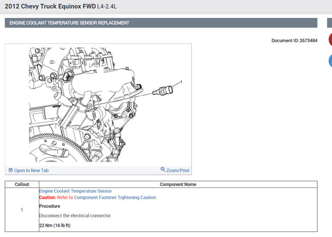

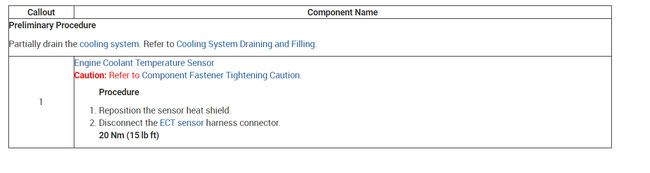

Here is a guide to help you step by step with instructions in the diagrams below to show you how on your car.
https://www.2carpros.com/articles/coolant-temperature-sensor-cts-replacement
Here are the thermostat locations for both 4 and 6 cylinder engines. Check out the diagrams (Below). Please let us know what you find.
