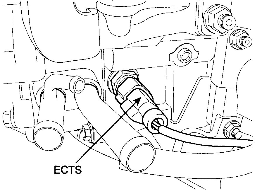

Where is the coolant sensor located and is it a straight forward fit replacement part please? Regards, Ross

The coolant temperature sensor for the computer is located in the end of the head on the driver's side of the engine. Use a socket to remove it but be quick as you will lose some coolant.
