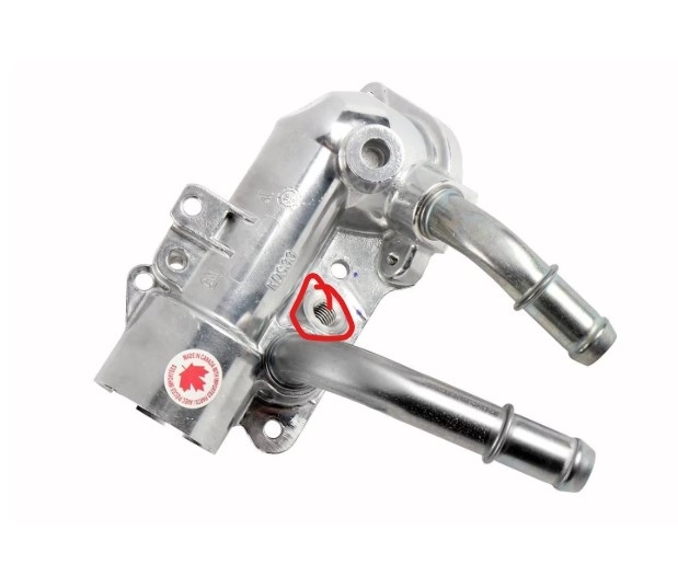

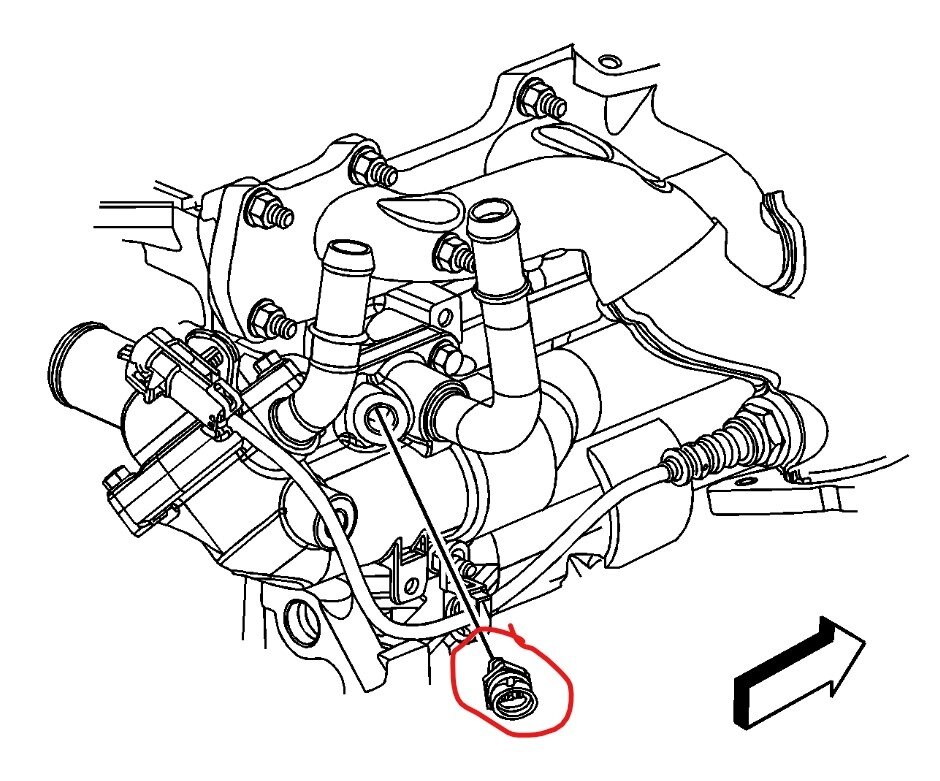

Where is the coolant sensor located on the hybrid
Mar 19, 2026 at 12:15 PM
STEVE W.
  • 15,352 POSTS
It is tucked into the thermostat housing on the back side of the engine. Look where the coolant lines connect to the housing, the sensor is between them. If you are replacing it, drain the coolant down, then remove the sensor, apply sealer to the replacement and tighten to 15 lb ft, it is tapered so be careful as the housings crack very easily.
