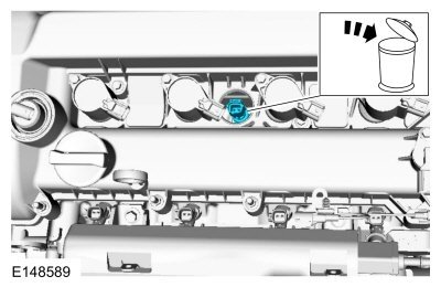

I am trying to locate where the cylinder head temperature sensor.
Apr 1, 2019 at 6:42 PM
  • 110,194 POSTS
Welcome to 2CarPros.

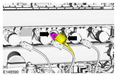

I attached two pictures to help you locate it. Let me know if this helps.

Thank you so much. I have been searching everywhere on the internet and always got the run around. So is this easy to replace?
Apr 1, 2019 at 7:44 PM
  • 110,194 POSTS
Welcome back:
It just screws out. You shouldn't have any trouble. Here are the torque specs for when you are installing the new one:
Installation
1. Note: Make sure that a new component is installed.
Torque : 106 lb.in (12 Nm)
Please note that the torque specs are inch pounds and not foot pounds.
If you run into trouble, let me know. I try my best to help you from here.
