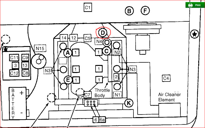

Where is the coolant sensor located and is it easy to replace?

The Coolant Temperature Sensor is located on the center rear of the engine. I have attached a picture of its location and circled in red. I have also attached a tutorial showing what is involved to replace. On a difficulty scale of 1-10 I would say it is a 5. Hope this helps and thanks for using 2CarPros.
