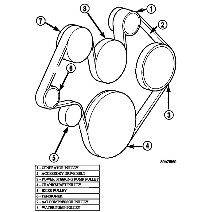

Runs at normal temperature while idling. But it overheats when driving speed limit. New: radiator, water pump, clutch fan, thermostat, coolant reservoir. After it heats up I can pull over and let it idle and it will cool back down. Motor was just installed. Had 120,000 miles on it. motor runs great. Please help.

This sounds like it could be a problem with the tension on the drive belt for the water pump. Can you please check and ensure that the belt is not slipping and get back to us with what you find out.

Checked belt. The belt was routed wrong. Would have never seen it if not checking the tension. Thanks so much.

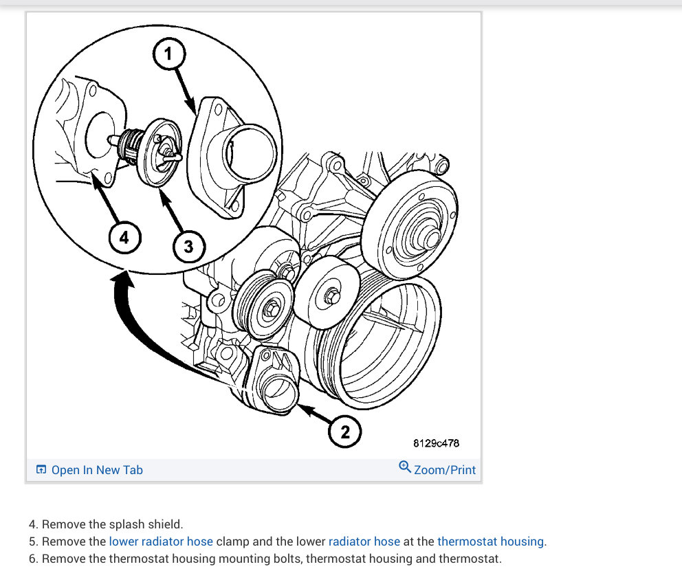

Belt is installed correctly but still getting hot. What's puzzling is top of radiator gets hot but the bottom is still cool. Only thing I can guess is thermostat is not opening up all the way.

Or maybe one of the hoses are sucking together and restricting the water flow at high speed.

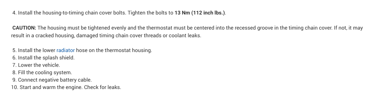

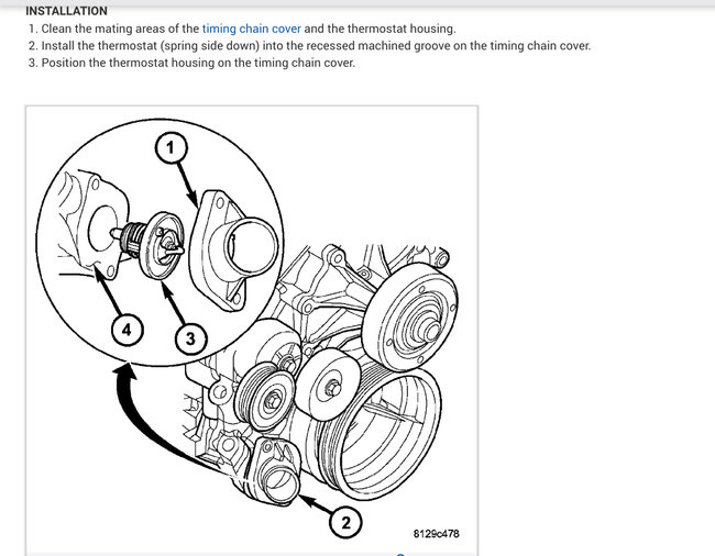

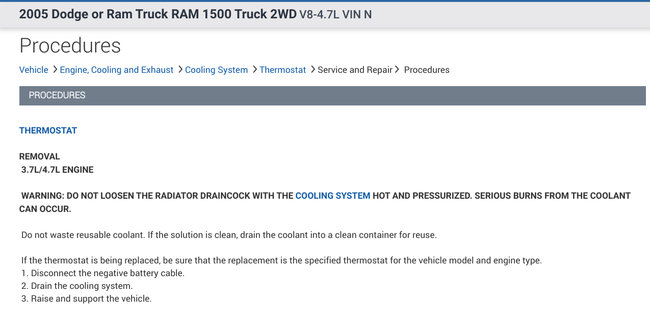

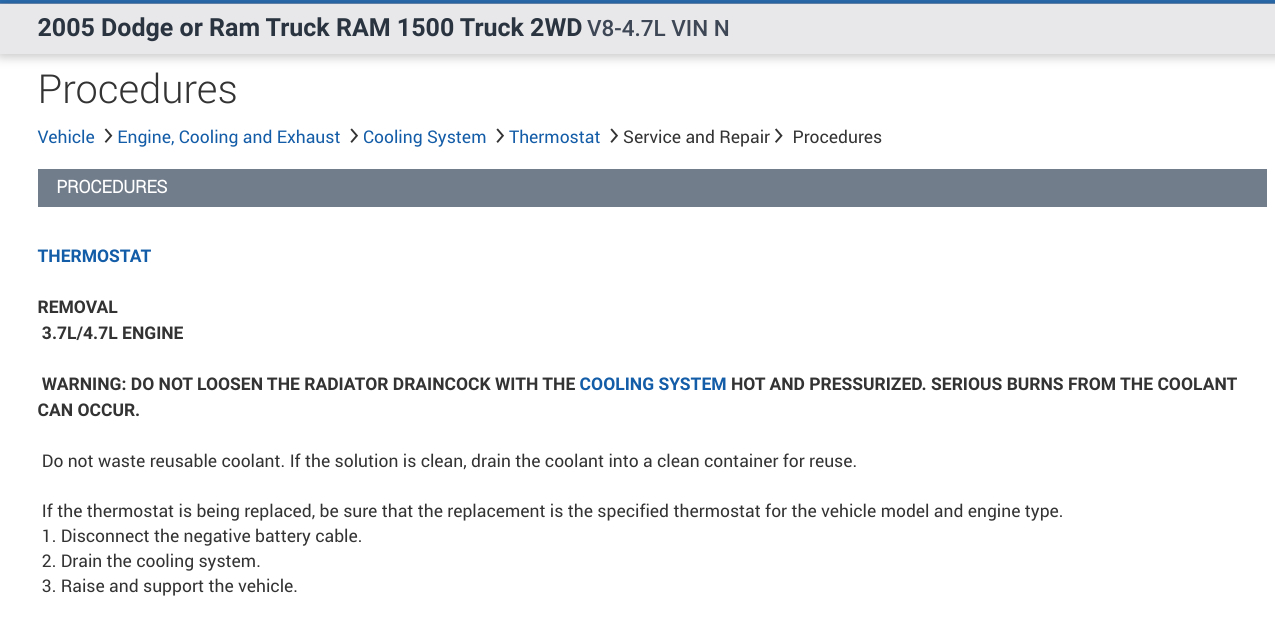

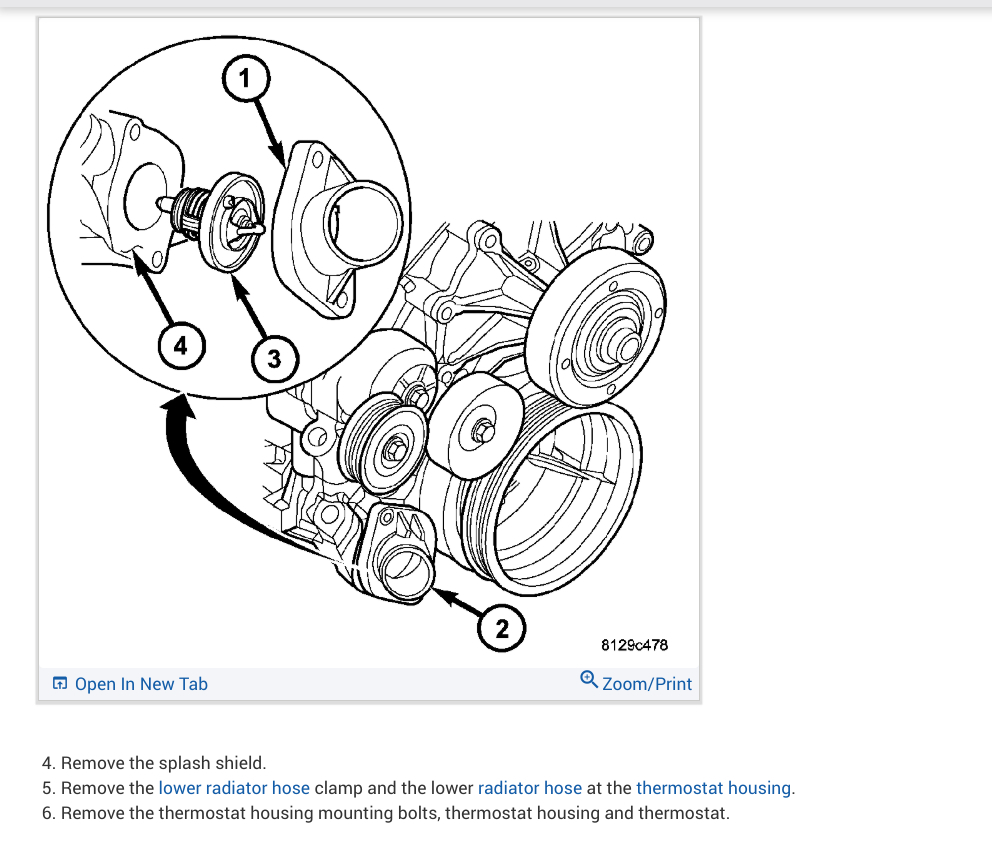

That sounds like a distinct possibility. Also I might add doing a cooling system flush and fill as well. Here is a link describing how to do it below:
https://www.2carpros.com/articles/coolant-flush-and-refill-all-cars
In the diagrams down below I have included the instructions for the removal and installation of your vehicle's thermostat. Please go through these guides and get back to us with how everything turns out.
Thanks,
Alex

Forgot, I had put new water pump and thermostat in old motor before they told me it needed another motor. So it sit for two years without any coolant in it.. so thermostat was dry the whole time. Thanks

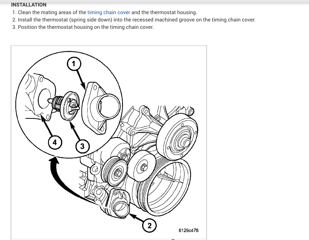

Does the radiator have a shroud ? if not this is causing the problem also let's double check the belt routing because if you are turning the water pump backwards it will cause this as well. Check out the diagrams (below). Please let us know what happens.
