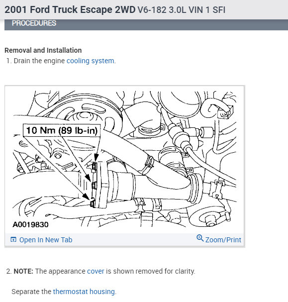

My coolant is steaming in the reservoir as well as leaking by the thermostat out of the heater hoses and it’s overheating, and my radiator hoses are hard as a rock when squeezing them.

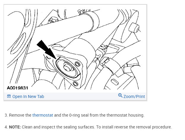

It sounds like you might have a stuck closed thermostat. The radiator hose will get stiff when the thermostat does not allow coolant flow and that is what leads to the overheating.
Take a look at these helpful guides:
https://www.2carpros.com/articles/engine-overheating-or-running-hot
I have attached the replacement procedure below for your reference.
Let me know of any questions.

Thank you so much, I put a different thermostat to the one I changed before with the new one. well, it ended up being the coolant control temperature sensor. I appreciate you though.
