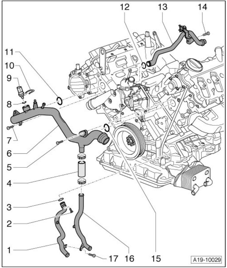

Coolant pipe
2009 AUDI A6
300,000 MILES • 3.2L • V6 • 2WD • AUTOMATIC
ROD1223
The car has overflow nipples at the radiator hose and on the coolant cross pipe. I broke the nipple on the cross pipe. Can I plug it at the cross pipe?
May 11, 2022 at 1:53 AM
STEVE W.
  • 15,295 POSTS
No, that isn't just overflow, it is a purge line to keep air out of the cooling system. You will need to replace that line to keep the engine happy and prevent cooling system problems.
Be careful though as Audi plastic tends to get very brittle with age. While you have the system drained it might be a good idea to replace any other suspect plastic as well.
May 11, 2022 at 2:41 AM
ROD1223
Thanks for your response, Steve. Now I have another problem. I replaced the serpentine belt yesterday, drove fine all day then when I started it last night the belt popped off and continues to pop off every time I start it, what could cause this?
May 12, 2022 at 2:05 AM
STEVE W.
  • 15,295 POSTS
Look at the belt routing to see if maybe a clamp or piece of the broken tube got stuck in a pulley or tensioner. If the broken part leaked coolant it could contaminate a bearing causing problems. Was the belt change the reason for the broken part?
