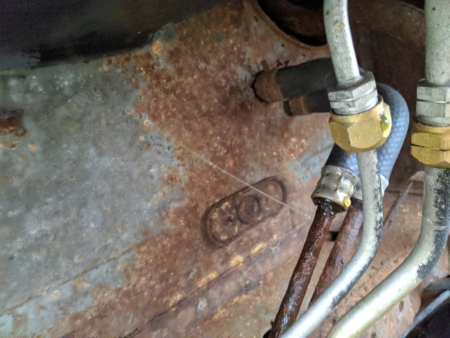

All my coolant leaked out under my driver's side next to my gas tank. It's leaking really bad, how do I fix it or can any tell me what parts I need to buy?

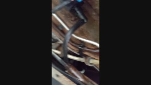

Here's a video:

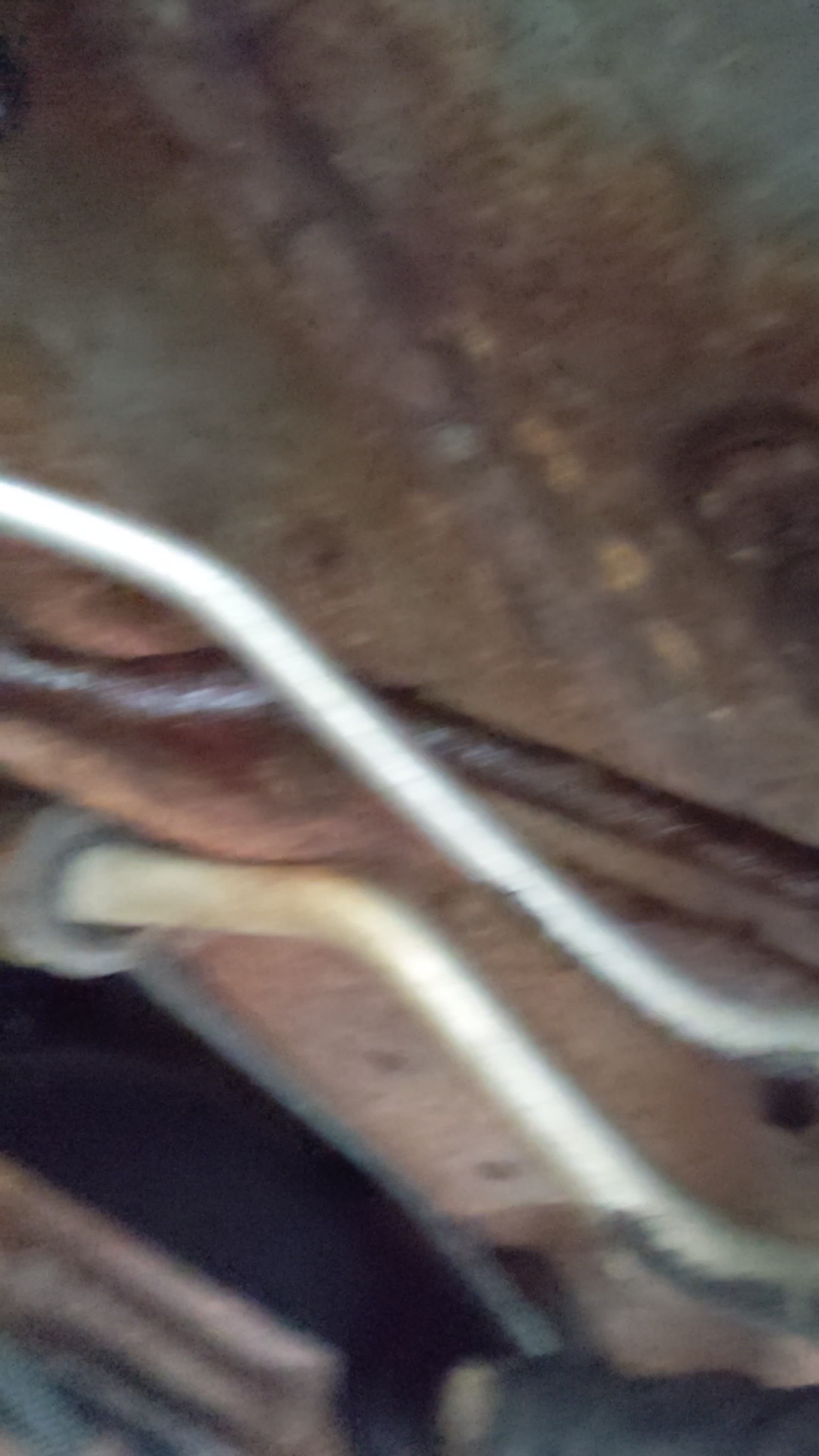

AMANDA DOWNEY
And a picture:

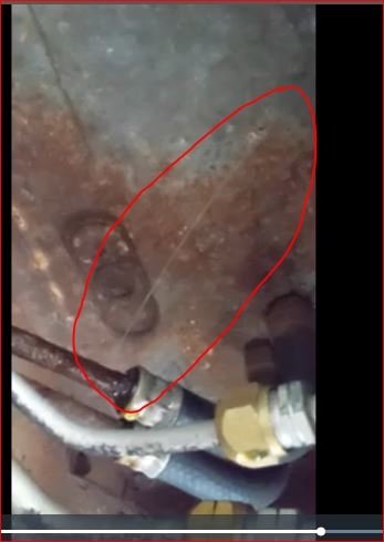

That is great. I just want to make sure I am seeing what you are seeing. I posted a picture of your video and circled what appears to be a small stream of coolant?
If this is the case, then that is a heater core line that has rusted through. This carries coolant to the rear heater core and will require replacement. As you can see that entire line is very dark and rusty. You could try and seal it but this will not repair it long term because even if you get it stopped, it will just rust through somewhere else.
Can you get a picture a little further back so I can better orient myself? Or you can just go down to the local parts store and have them look at the line. They can identify which one it is and then look it up for you.
I can then get you the procedure on how to replace it if you would like.
Either way, I will assist with what you need but that line needs replaced. Thanks
