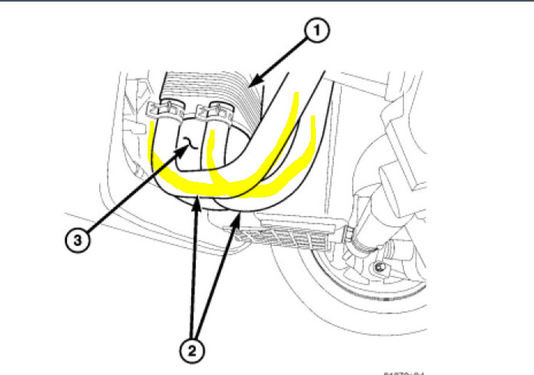

The heater has been giving me issues for a while now. At first the heater wouldn’t put out heat unless driving down the road. Now it doesn’t work at all. A/C and blower and blend door work fine. I thought it was a clogged heater core because one line was warm and the other cold. I pulled both lines, and the heater core wasn’t clogged at all. Water flowed through easily both ways. Then I put a jumper hose connecting both heater core hoses and no coolant is flowing through. I also changed the thermostat and bled all of the air out of the system. Still has no coolant flow through those heater core lines. The engine runs great, no overheating and upper and lower radiator hoses get hot.

I have a feeling the oil cooler is plugged and preventing coolant flow to the heater core.
Engine coolant flows into the oil cooler from the heater return tube and exits into the water inlet tube. If the cooler is clogged (I've seen it before) coolant can't flow through the heater core.
I attached a pic below showing the cooler. It is right near the oil filter. In the pic, the number 3 points at the filter.
Let me know what you find.
See pic below.

I think you are right. I pulled both lines off of the oil cooler and put a piece of tubing connecting the two lines and started the car and the heat worked perfectly. I ordered a new oil cooler, and it should be here tomorrow. I’ll let you know.

That is the problem. I've seen a few but the issue seems to be becoming more common.

Well, I found the issue. The oil cooler wasn’t allowing any coolant to flow through it. I replaced the oil cooler and now it works like brand new, and the engine runs cooler as well. Thanks for the help.
