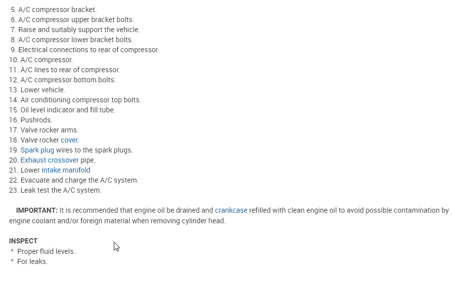

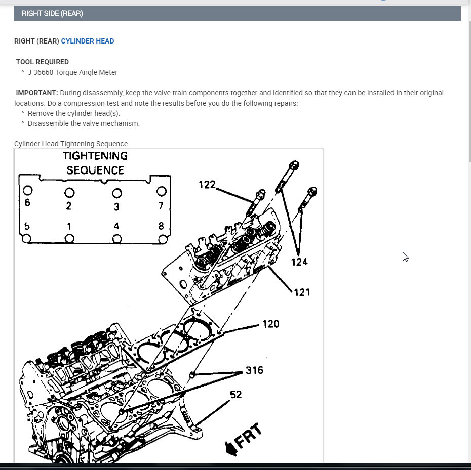

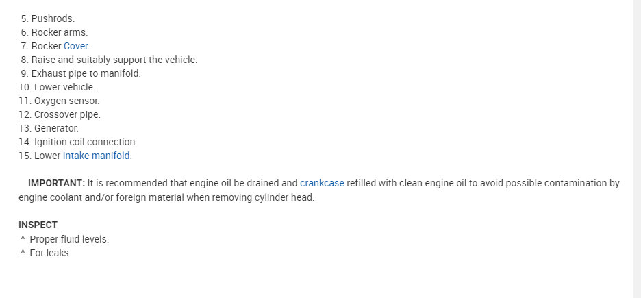

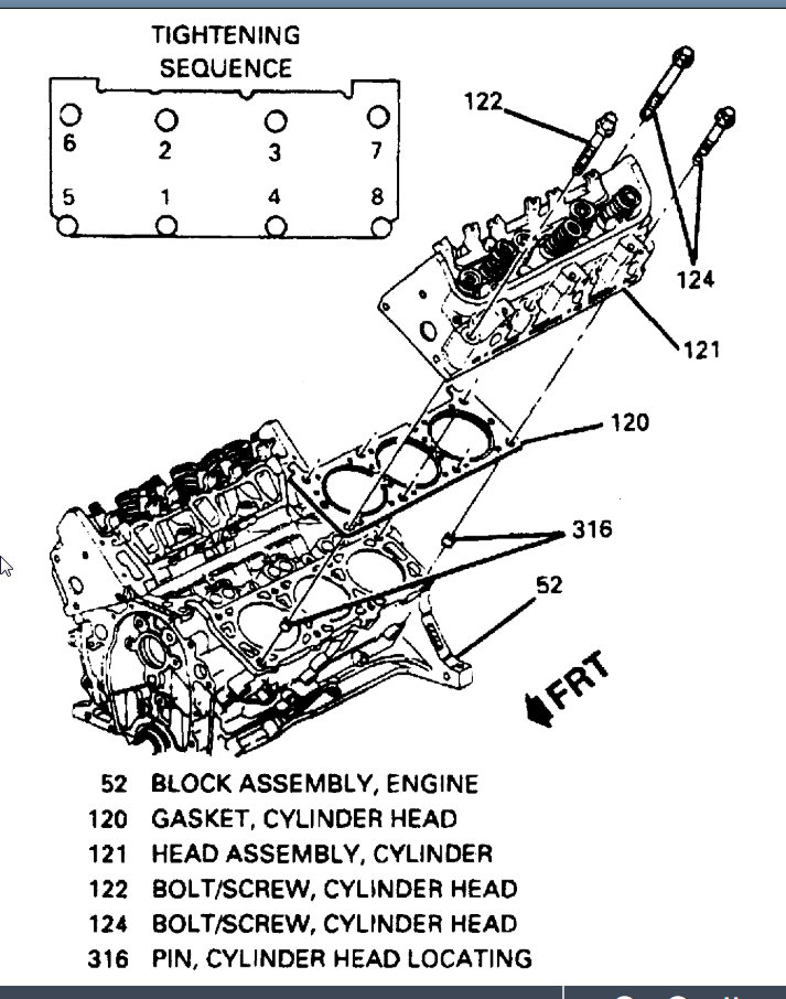

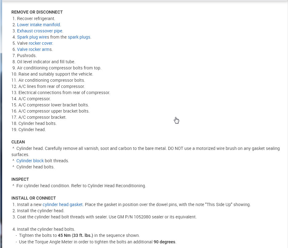

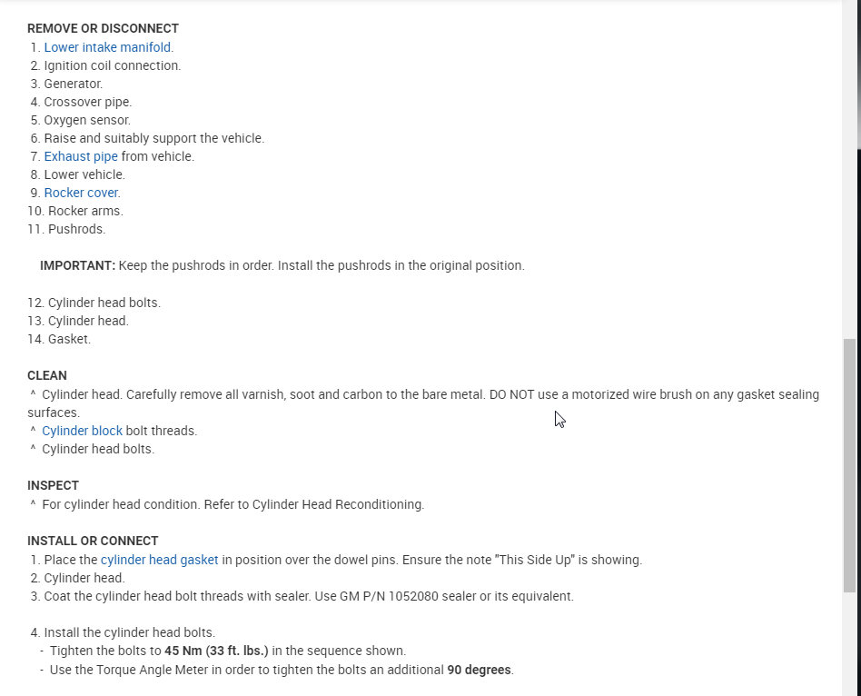

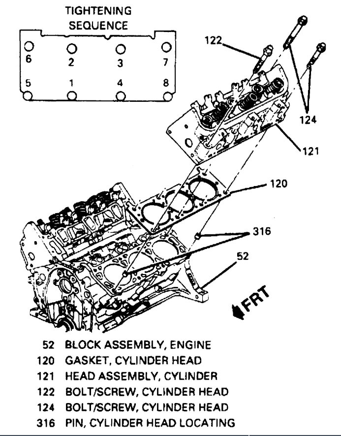

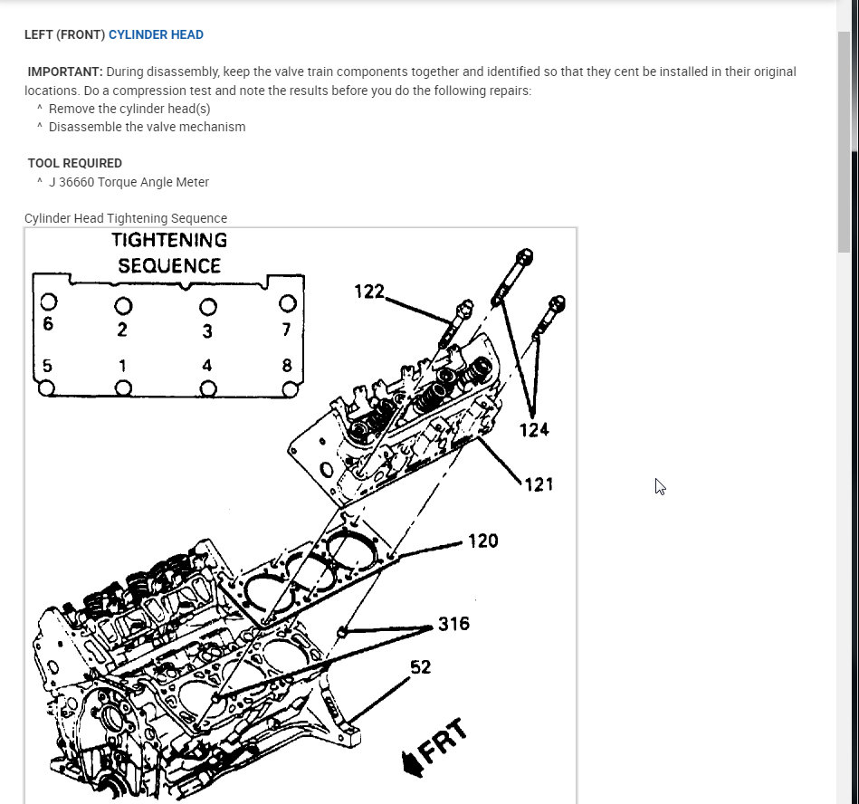

Okay. I think it is safe to say you have a head gasket issue. The issue you have at this point is which bank, front or rear? To find this we need to do a compression check or cylinder leakage test to identify which cylinders unless you want to do both banks. Clearly it is only necessary to do the one that is failed so I would highly suggest trying to narrow this down.
I included the process for both heads in case you choose to just do both sides.
Let me know what questions you have.
