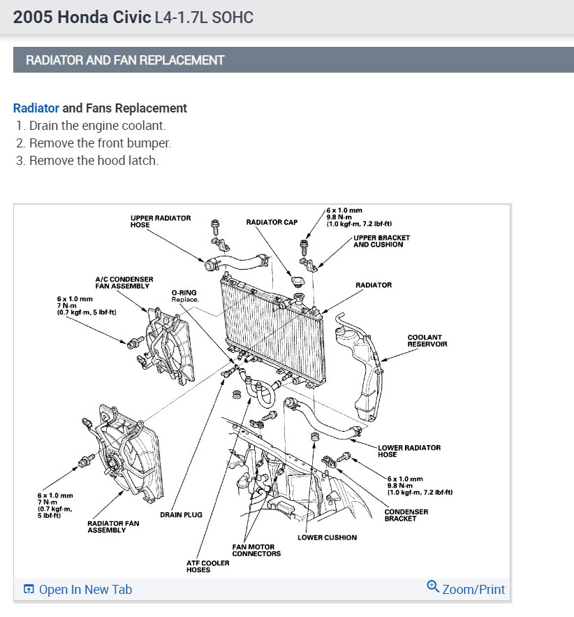

Sometimes when the radiator starts to leak the coolant will dry as fast as it leaks out, so it is difficult to tell what's going on. I would use a flashlight and check both sides of the radiator tanks to look for reddish powder, if so, the radiator needs to be replaced. Here is a guide that can help you find the leak:
https://www.2carpros.com/articles/car-is-leaking-coolant

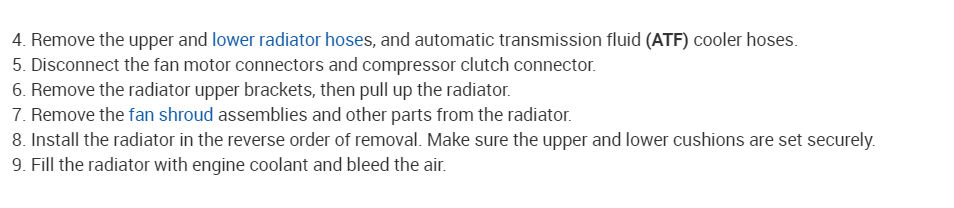

Also included how to change the radiator just in case, in the diagrams below. Check out the diagrams (below). Please let us know what happens.

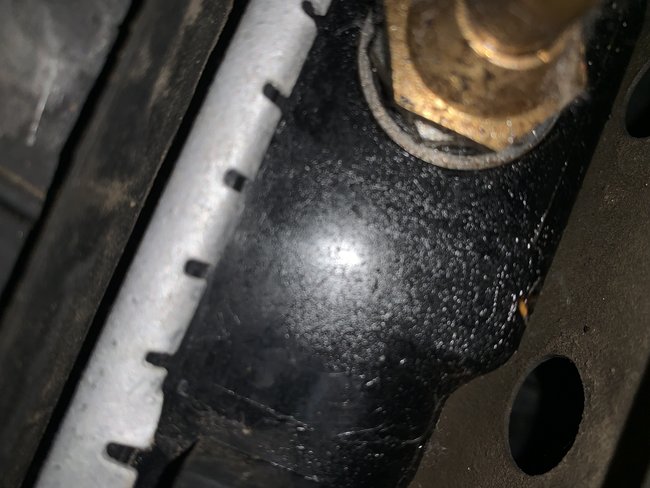

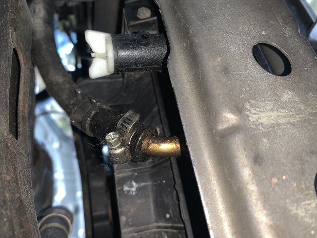

So, I got underneath and noticed that this hose had some built-up gunk on it, is this at all related? It’s about an inch over from my drain plug. Also noticed that the bottom of what I’m pretty sure is my radiator is kind of wet too, I just don’t know if it’s new or not.
Jul 12, 2022 at 6:32 PM

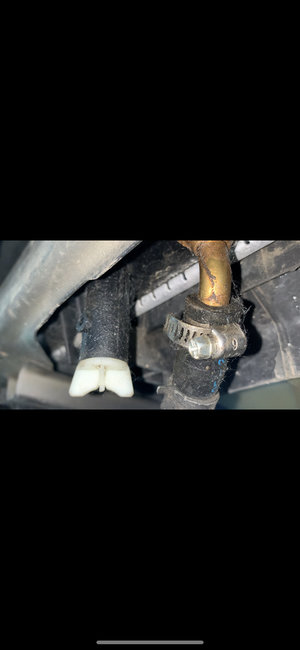

JAS0822
  • 74 POSTS
Another picture.

  • 54,832 POSTS
Hmm, it is hard to tell if that is your leak or not, I would make sure the coolant is full, then let it run in one place for fifteen minutes and then look under it to see if there are any coolant puddles. Also, the chemical test is only about 70% accurate, you can remove the spark plugs and see if one is clean compared to the others, this will tell you the cylinder that has the leak.
