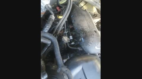

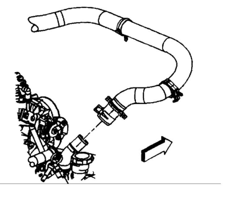

I have a coolant leak about the size of a brake line, that runs from head to head, in the top front of the engine.
I cannot find it online and it is leaking too bad to take it anywhere.
If I could just get the correct name.

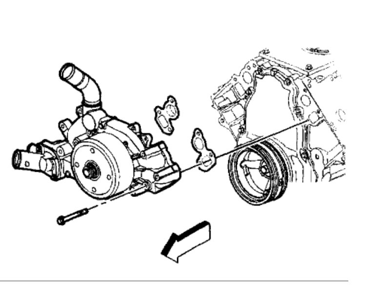

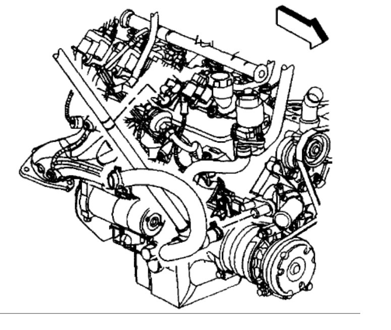

It looks like it is coming out of the water pump gasket. You must start by draining the coolant.
Here is a guide and some diagrams (below) to help you get the problem fixed:
https://www.2carpros.com/articles/water-pump-replacement
and you will need to take the fan clutch off.
https://youtu.be/N_-MLVlBHk8

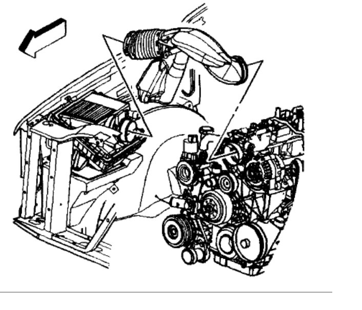

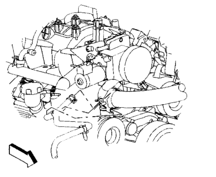

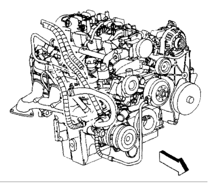

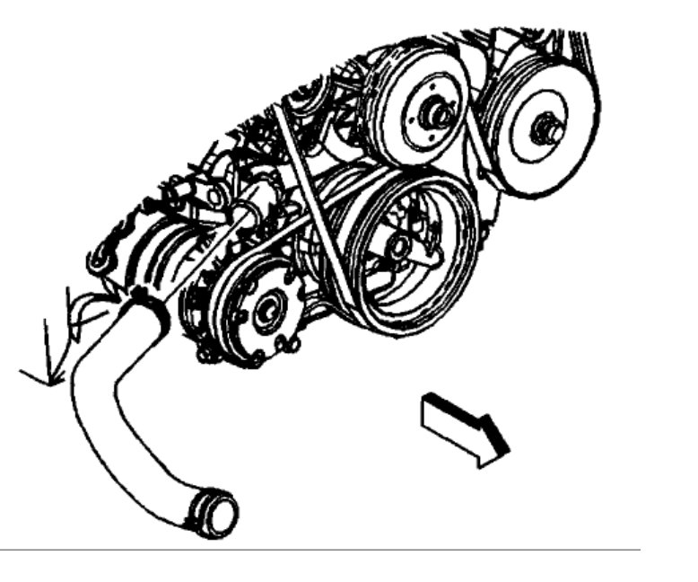

Below are some diagrams on how it is on your car.
Here is a pump on Amazon for $91.00:
https://www.amazon.com/ACDelco-252-845-Professional-Water-Pump/dp/B001KSG24Y/ref=sr_1_2?ie=UTF8&qid=1506977984&sr=8-2&keywords=2003+chevy+silverado+water+pump
Please let us know what happens and upload pictures or videos of the problem.
