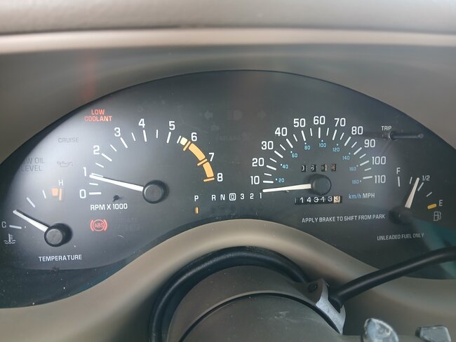

Coolant light randomly turns off/on
Coolant level is full. New coolant is in it and old still doing it. Also burped the system.
Water pump okay. Fuse, good.
Not buring oil or mixing.
No, holes in the line. No leaks.
Radiator flushed.
Haven't found a single leak.

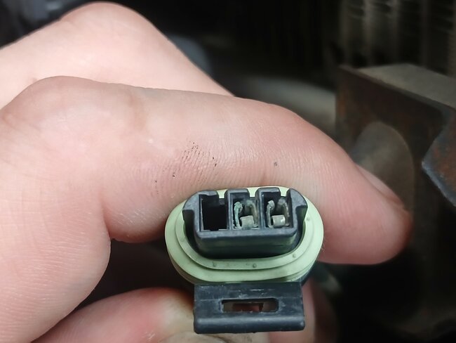

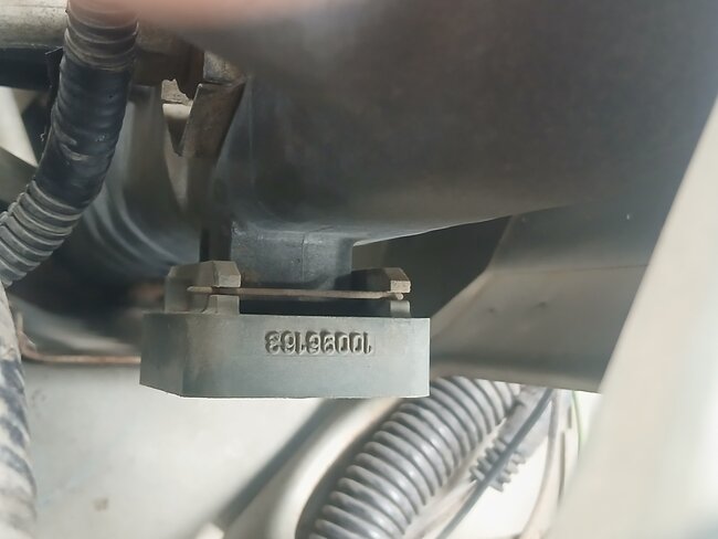

I have also noticed the sensor was unplugged from the radiator. Temp gage i think?
When Its unplugged. Coolant light turns off. If plugged in. Coolant light wont shut off.

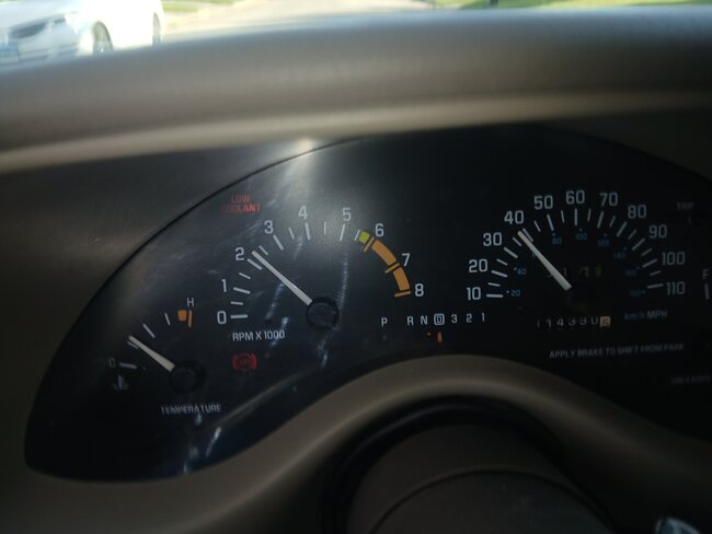

and RPM running little over 2. When idling goes up and down from 0-2 kinda fast.

Also not normal?

Sounds like the problems in the coolant temp sensor that the wire was unplugged at ..probably defective ..theyre cheap on online you can most likely get one for less than 10 bucks ..and that plug need a good cleaning you can use a mechanics Pic to scrape out some of the junk the spray it out gently so not to damage it then it should be ok if not get back to us if you need any help
Let us know how it goes
best of luck .

Yep also check the back of the plug where the wore come in to see if theres an extra wire that's not connected corroded and the like ... it appears to have one missing inside might have fallen out at some time due to corrosion but the wire should still be there with the other two if it is you need to repair that if not than check the sensor fir the same issiues..these might be the only problem most likely they are .. let us know how that goes thanks good luck
