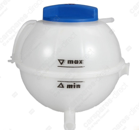

It goes off again shortly after, yet it doesn't come on when stop starting due to walk. i've found a clicking noise when where a small length of pipe had split once replaced that's stop clicking and hissing. so, wondering if that could be issue as the car runs great otherwise..

Have you stopped to check the coolant level once the warning light comes on?
When really hot, such as on a long-distance drive, the cooling system will build up pressure which will physically compress the coolant and lower the actual level.
When cold the coolant level should be on or near the maximum mark.
When really hot the coolant level should not be lower than the minimum mark
See image below
How to check:
https://www.2carpros.com/articles/how-to-check-engine-and-battery-pack-antifreeze-levels
Hope this helps.
Cheers, Boris
