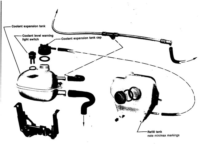

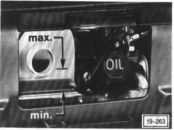

When I start the van the red warning light continues to flash. I have topped up the coolant reservoir to the correct level, the light continues to flash. I was told sometime ago that there is another coolant bottle. I need the location to check it out. Thanks, John.
Aug 6, 2018 at 5:14 AM
  • 110,244 POSTS

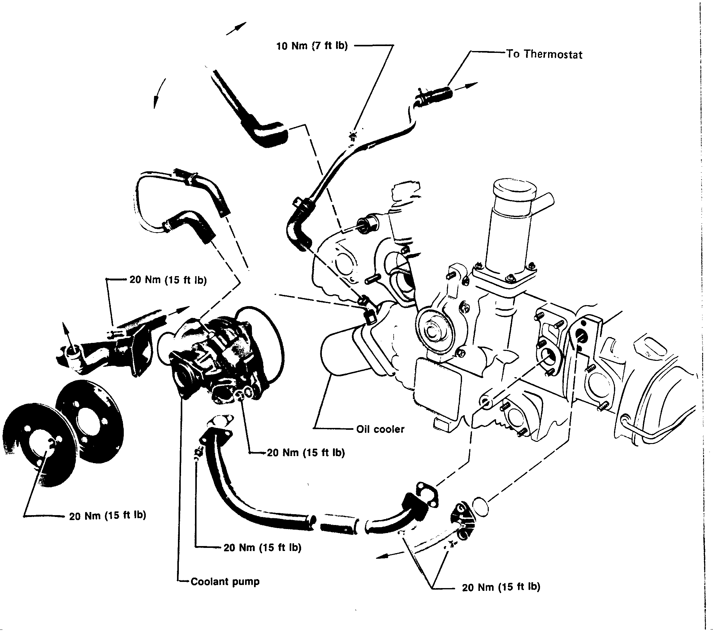

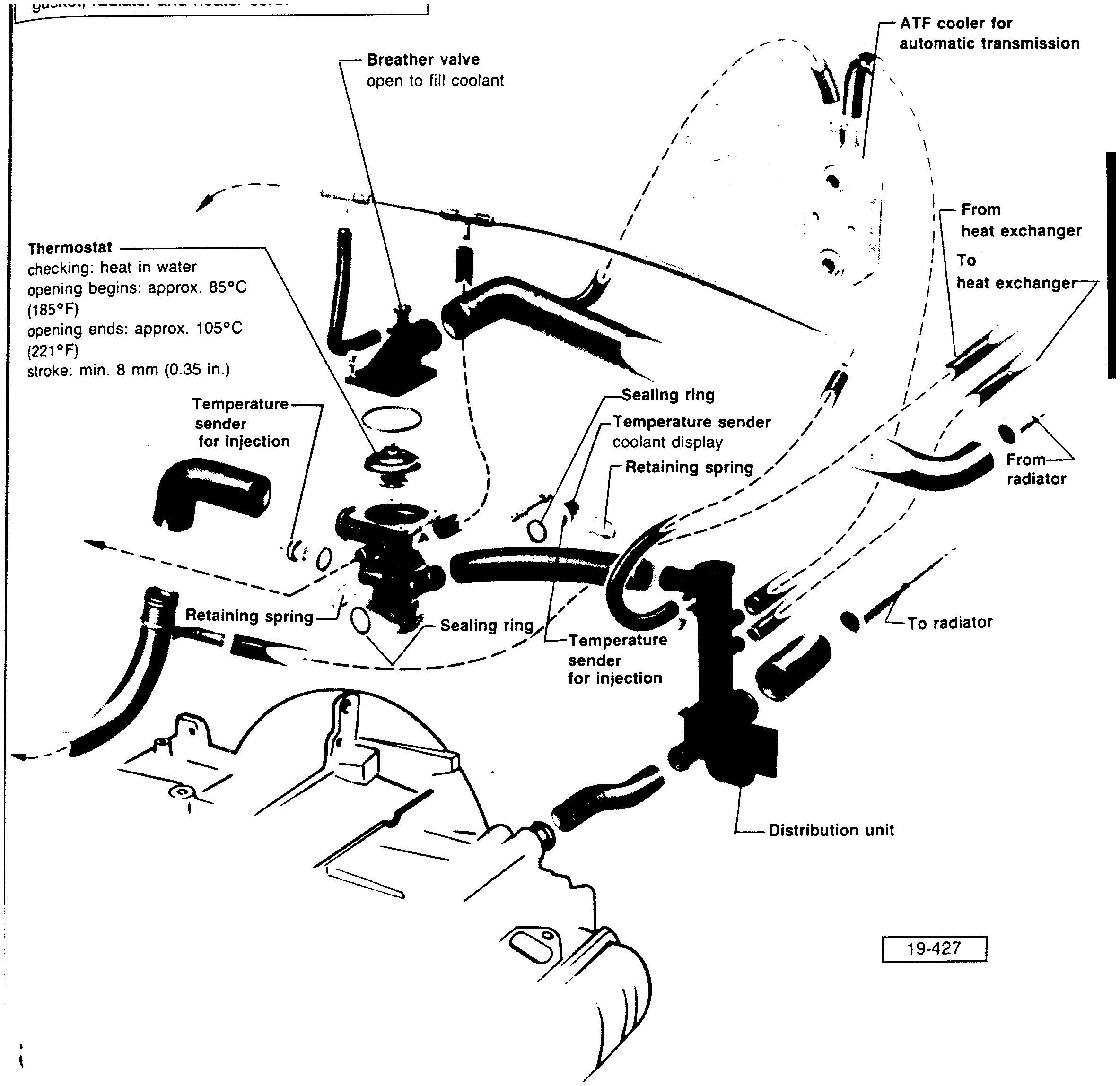

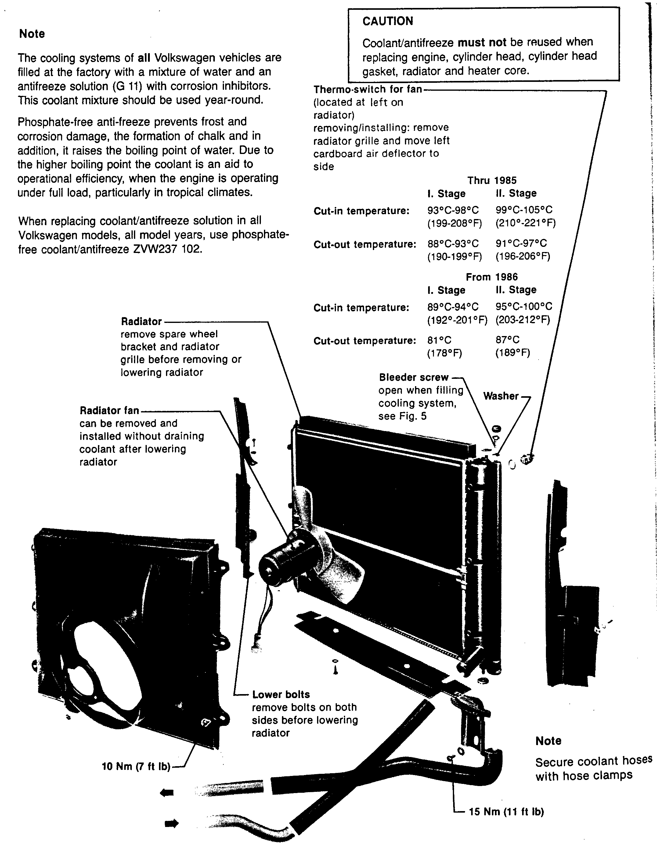

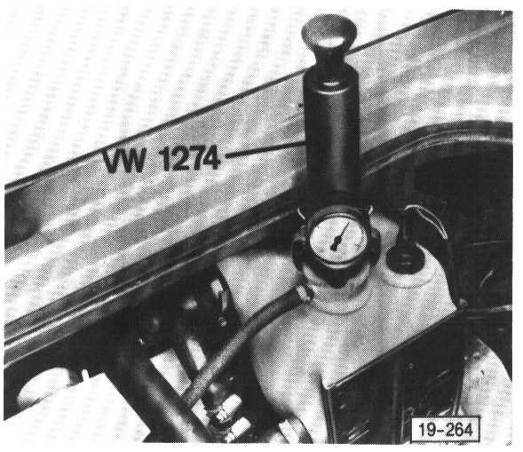

I am not familiar with a second reservoir. I have attached four pictures of the system for you to look through. They are exploded views of the system and components. I will tell you that there was a technical service bulletin indicating that the water pump may leak very small amounts of coolant onto the sensor which can lead to the light being on. Picture 5 is one I am not familiar with, but take a look at it and see if that helps. Picture 6 is the one I am familiar with.
Additionally, here are a couple links which describe temperature sensor issues as well as how to pressure test a cooling system to find a leak:
https://www.2carpros.com/articles/symptoms-of-a-bad-coolant-temperature-sensor
https://www.2carpros.com/articles/radiator-pressure-test
