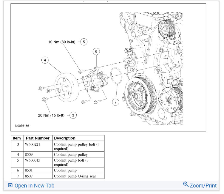

My car has a strong lack of coolant but I'm not sure where it leaking exactly. I only noticed that it leaking under fan belt. I am not sure whether it is in water pump or what?
Please help
Feb 2, 2019 at 7:19 PM
  • 55,399 POSTS
It does sound like the coolant pump is leaking. but to be sure here is a guide to help confirm the issue:
https://www.2carpros.com/articles/car-is-leaking-coolant

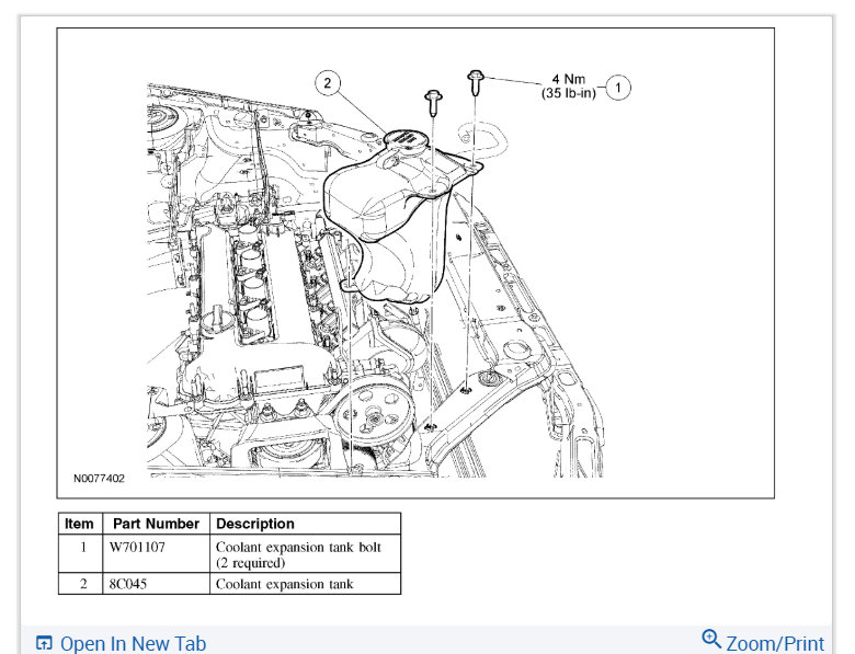

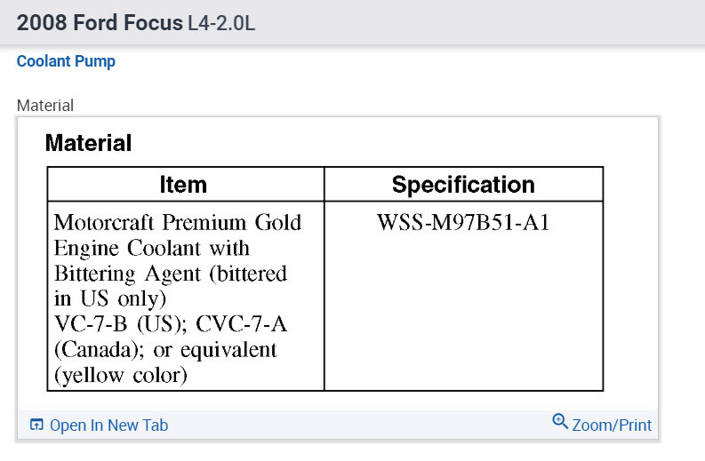

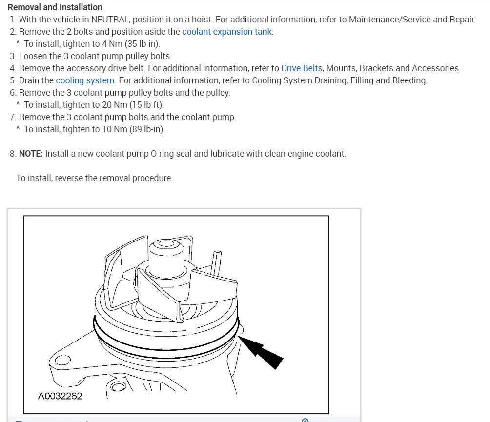

If the water pump is leaking here is a guide to help walk you through the repair with diagrams below to show you on your car:
https://www.2carpros.com/articles/water-pump-replacement
