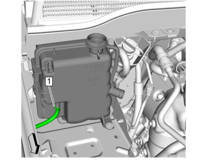

Good afternoon,
The sensor is part of the tank and the tank will need to be replaced. I attached the procedure below for you for the repair.
As far as the previous repair, there is no connection between the 2 repairs. Replacing the fan clutch does not require the tank to be replaced.
Removal Procedure
Caution: The cap mounted to the top of the surge tank uses LEFT HAND threads. Turn the cap clockwise to remove the cap or counter clockwise to install the cap. Failure to turn the cap in the proper direction when installing or removing it may cause damage to the cap and/or the surge tank.
Drain the cooling system. Cooling System Draining and Filling

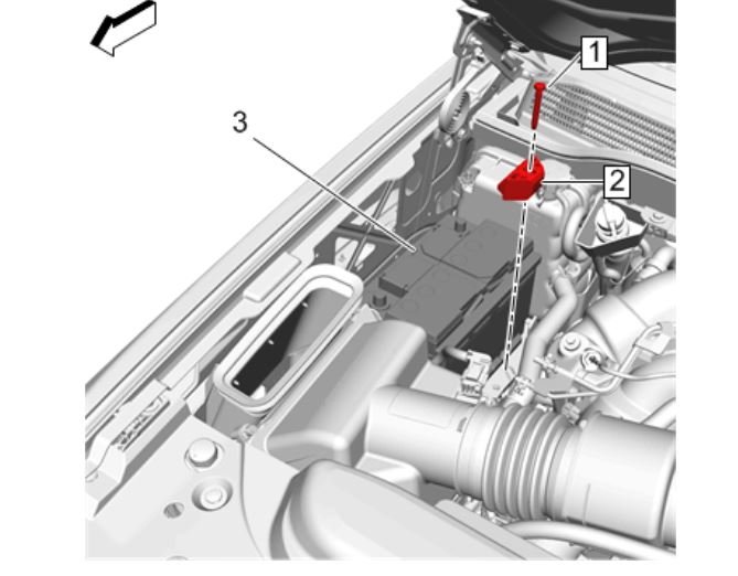

Battery (3) » Remove — Battery Replacement
Open In New TabZoom/Print

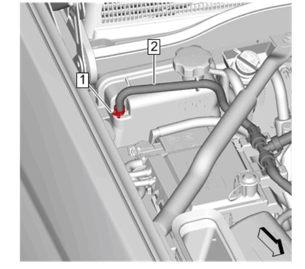

Radiator Surge Tank Inlet Hose (2) @ Radiator Surge Tank » Remove — Radiator Surge Tank Inlet Hose Replacement

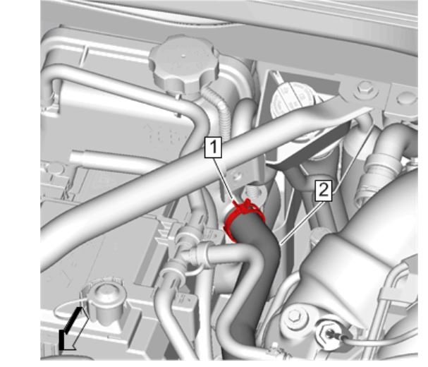

Radiator Outlet Hose (2) @ Radiator Surge Tank » Remove — Radiator Outlet Hose Replacement

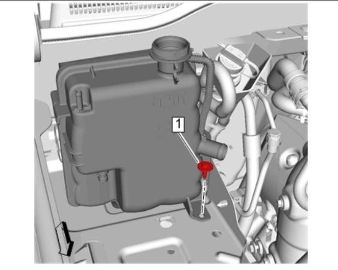

Radiator Surge Tank Bolt (1) » Remove

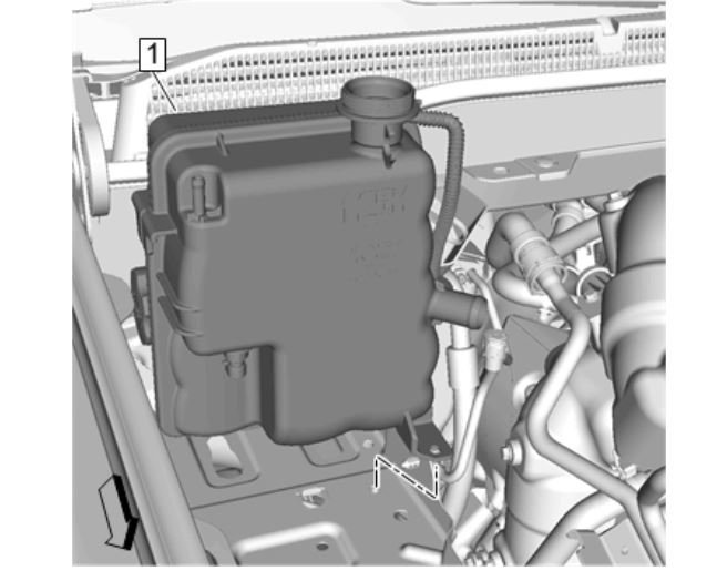

Radiator Surge Tank (1) » Remove
