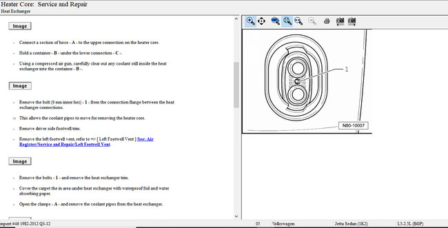

Thank you as I've had time to think about it I remember smelling some coolant inside the car. Is it possibly the heater core? There's no leaking inside of car just curious. Thank you in advance.
Feb 11, 2021 at 9:28 AM
KIDPLASMA
One more thing; is it possible or recommended if it is the heater core could I or should I use radiator sealant until I can get it repaired?
Feb 11, 2021 at 9:45 AM
SEVAG P
  • 405 POSTS
hello,

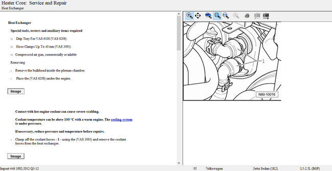

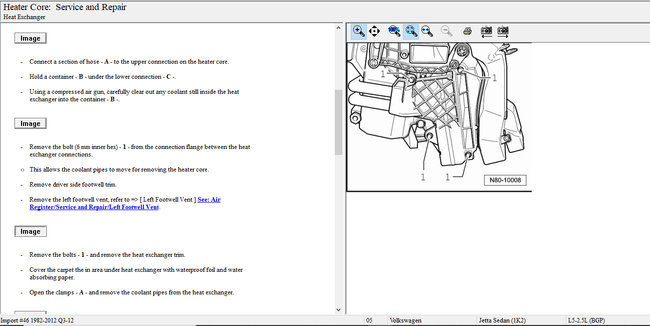

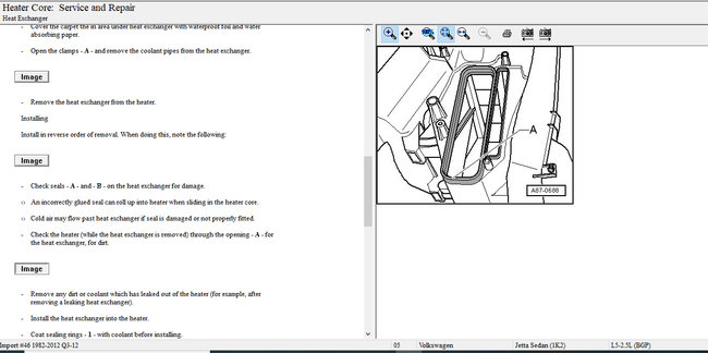

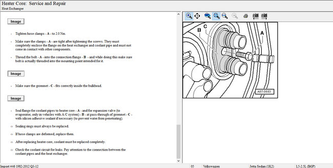

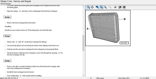

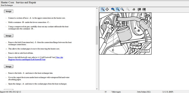

yes, it's possible from a leaky heater core, to make sure remove the surrounding carpets pressurize the system you must detect the leak because its present you can smell it.
i prefer to use liquid radiator sealant not the powder type, and use good known brand, it can seal only the small leaks. you can try.

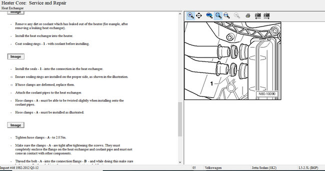

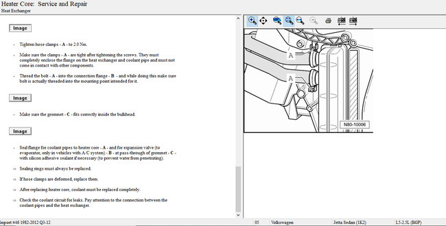

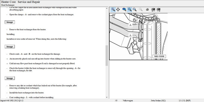

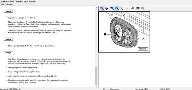

https://www.2carpros.com/articles/replace-heater-core
Check our diagrams below how to replace heater.
let us know if you need more help.
thank you.
Feb 12, 2021 at 2:32 AM
