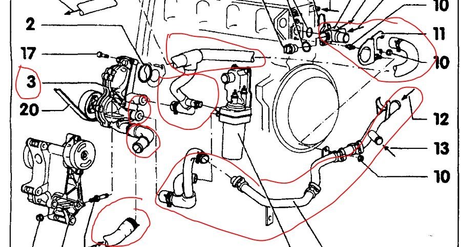

I just had a mechanic shop put in a new water pump. Now my coolant is leaking from the passenger side, under the engine. Also the car is still sounding rough, I took it back to the same mechanics and they claim that they don’t know where the leak is coming from. The rough noise I still hear is something to do with the automatic steering. What the heck?

Coolant can be leaking from a few places. Here is a link to help locate and repair the leak:
https://www.2carpros.com/articles/car-is-leaking-coolant
If you are unable to locate the leak, you may have to pressurize the system to help find it. Here is a link that shows how to do that. You will need the correct tool needed, but most parts stores will lend it to you.
https://www.2carpros.com/articles/radiator-pressure-test

As far as the issue, since work was just done on the vehicle, I would demand they fix it. Now where it is coming from is to be determined. There are several hoses, clamps, and o-rings that can cause a leak. I attached a picture for you to see. I circled number 3. That is pointing to the water pump, which is on the passenger side. Everything else I circled carries coolant and can leak.
Because there are so many possible places for a leak, it really should be pressure tested. Otherwise, it will become a guessing game.
Let me know if this helps.
