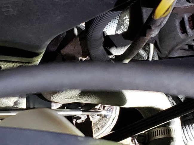

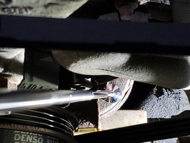

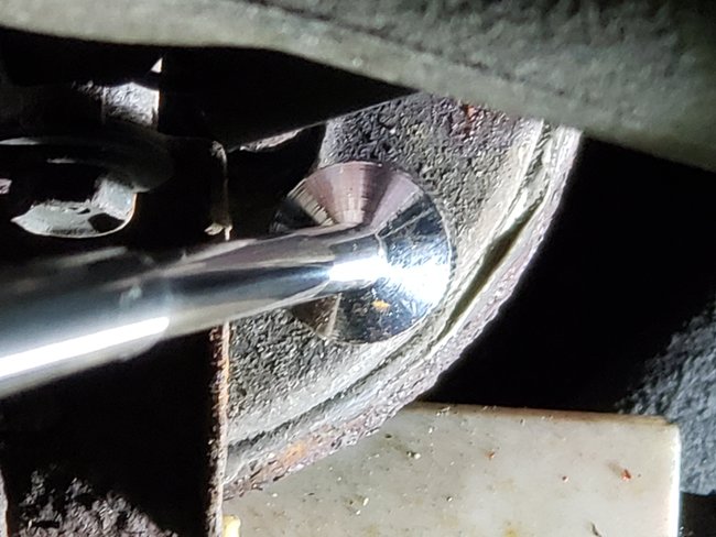

Hi. The coolant (on my vehicle listed above SR5) is leaking on the engine joint near the oil dip stick. Sorry, I don't know what to call it. On picture 1, using my magnetic pick-up pointer, you can see the rubber gasket where I saw the coolant slowly dripping. On picture 2, you can see the yellow oil dip stick handle then my magnetic pointer close to the source of leak from a further view. What can you suggest to on how to fix this without breaking the bank? Thank you very much for your help.

The pictures didn't upload. Can you do it again? The thermostat housing is on the front of the engine and I suspect that is what you are referring to, but I'm not sure.

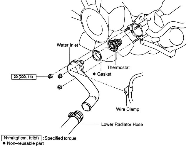

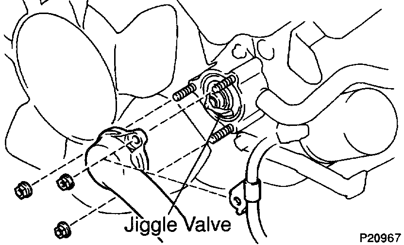

The first picture I attached shows an exploded view of the thermostat housing and its components. Take a look at it and let me know if that is the problem. If it is, the housing will need removed and you will need to replace the rubber o-ring gasket. Here are general directions for replacing the thermostat which will show removing and replacing the housing. Also, if you do remove the housing to replace the gasket, replace the thermostat while you have it apart. It isn't expensive and if original, you should do it as preventative maintenance.

PROCEDURES
See Picture 1
REMOVAL
1. DRAIN ENGINE COOLANT
2. DISCONNECT LOWER RADIATOR HOSE
See Picture 2
3. REMOVE THERMOSTAT
a. Remove the 3 nuts, wire clamp, water inlet and thermostat with gasket from the water pump.
b. Remove the gasket from the thermostat.

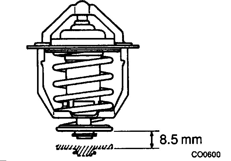

See Picture 3
a. Immerse the thermostat in water and heat the water gradually.
b. Check the valve opening temperature and valve lift.
Valve opening temperature: 80 - 84°C (176 - 183°F)
Valve lift: 8.5 mm (0.335 inch) or more at 95°C (203°F)
If the valve opening temperature and valve lift are not within specifications, replace the thermostat.

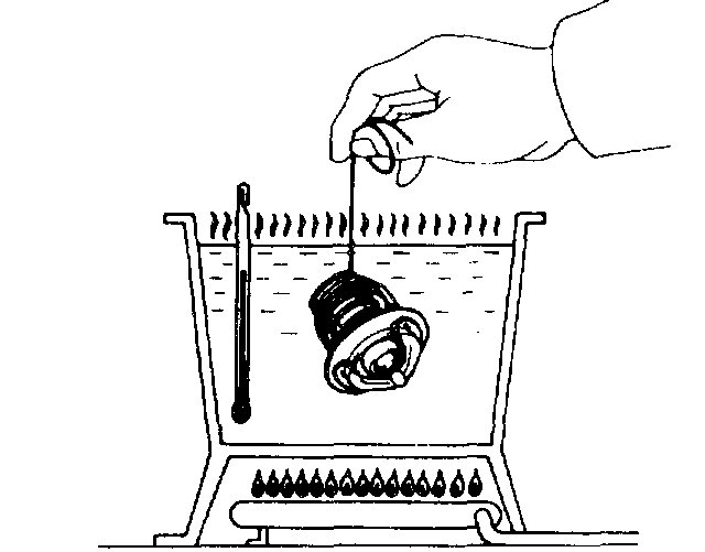

See Picture 4
c. Check that the valve is fully closed when the thermostat is at low temperatures (below 40°C (104°F)). If it is not tight, replace the thermostat.

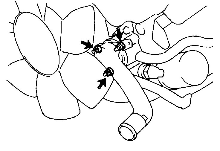

See Picture 5

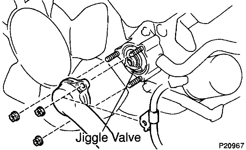

1. INSTALL THERMOSTAT
a. Place a new gasket to the thermostat.
b. Install the thermostat with the jiggle valve downward.
c. Install the water inlet with the 3 bolts.
Torque: 20 Nm (200 kgf-cm, 14 ft. lbs.)

Let me know if this is the problem. If it isn't, please upload the picture so I can get a better idea of the problem.

Hi Joe. Were you able to see the pictures that I uploaded?

Thank you for your immediate response. I am re-uploading the photos again where the leak is coming from.
I think it is not the thermostat. I hope I'm wrong.

There are so many places coolant can leak that it is impossible to tell from pictures.
You need to pressure test the system and use a bright LED light to find the source of the leak.

That is roughly the location of the thermostat as well as the water pump and different hoses. I can't tell exactly where you see the leak in the pics. With that being said, I am going to recommend you pressure test the system to help determine where the leak is actually coming from. You will need a pressure tester. It is nothing more than a pump that attaches to the radiator. You remove the radiator cap and attach the pump and pressurize the system. Then, when the engine is cold, you can take your time without getting burned and locate the problem. When the system is pressurized, you should see the leak.
