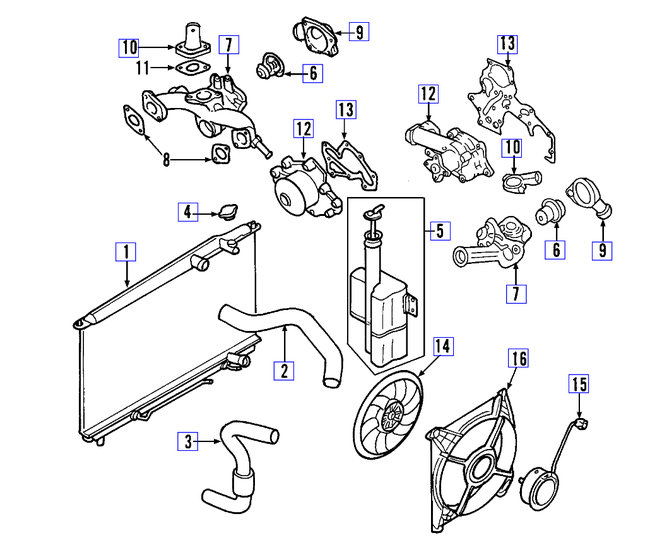

I was driving and all of a sudden my temperature gauge started rising. I pulled over to let it cool down then checked the coolant level. It was low so I went to the store and got some more. I headed back home and it was good for a couple minutes but it started heating up again I stopped to check and coolant was running out of the bottom of the car.

That is definitely not good. Can you tell where the coolant is leaking from? If not then you will need to do a cooling system pressure test to see where the leak is before it can be fixed. I have included a link below for you to go to.
https://www.2carpros.com/articles/radiator-pressure-test
Please go through this guide and get back to us with where the leak is coming from and we will go from there.

I saw coolant splashed on the firewall and it was leaking from underneath the car. The radiator, radiator hoses and thermostat were all dry.

Okay, without a pressure test there is no way that I can tell where it is leaking from. I would check the weep hole on the underside of the water pump, loose hose clamps on upper/lower radiator hose and heater hoses. Where ever it is leaking there should be a washed spot with the amount of coolant you are talking about. If you plan on driving it to the shop, please make sure to take three or four gallons of water with you to keep water in it until you get there. Also, if you do start to overheat always have your engine on and running when adding water/coolant to the system, if not you run the risk of cracking your engine block without having the engine running to circulate the water. I have included an exploded view of your vehicle's cooling system in the diagrams down below for help identifying where the leak is. Please keep us informed.
