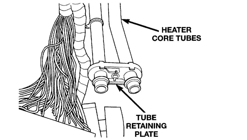

Purchased this van used. The heater core was bypassed i got hoses and hooked it back up hoping to find the problem. When the van is started water is pouring out from in the very middle like underneath the radio and heat/cool control panel. Please help i do not know what this could be.

If it is coolant, it is leaking from a failed heater core. It is the only component inside the car that carries coolant. It must be replaced to resolve the issue.
Are you going to attempt it yourself?

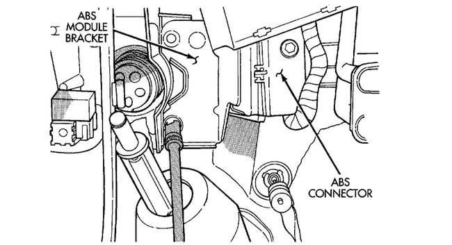

4. Remove ABS module, bracket and wiring.

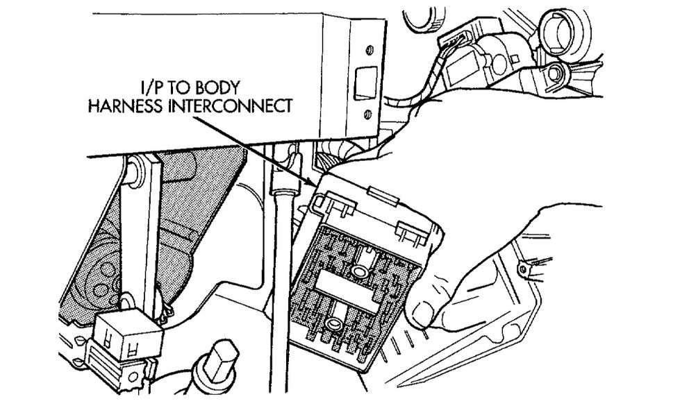

5. Remove I/P to body harness interconnect and bracket.

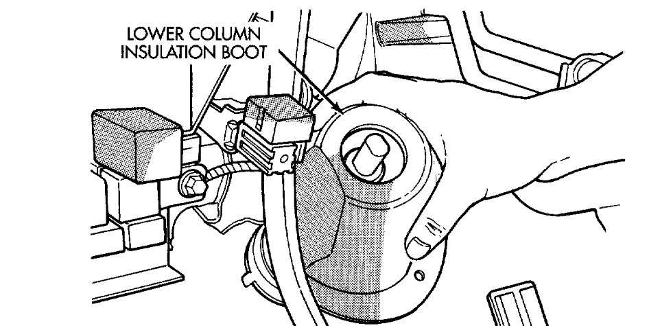

6. Remove lower silencer boot at base of steering shaft.

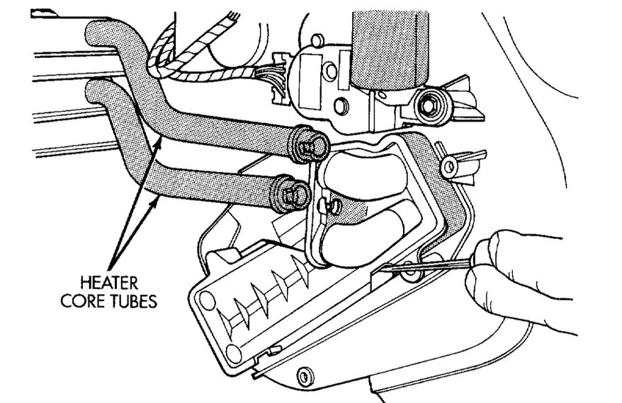

7. Pinch off heater lines under the hood.
Heater Core Plate And Tubes
imageZoom/Print
8. Remove heater core cover. Insert a small amount of towels under the heater core tubes. Remove heater core plate and tubes.

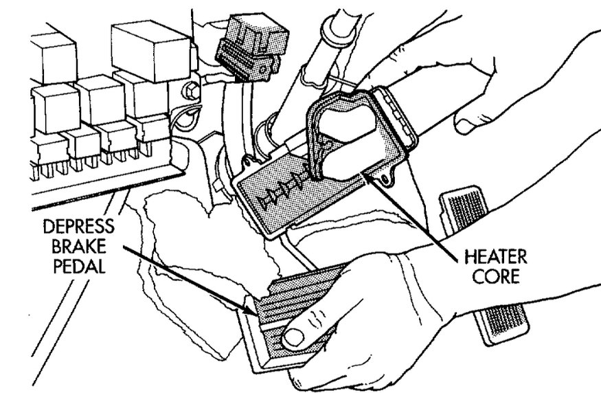

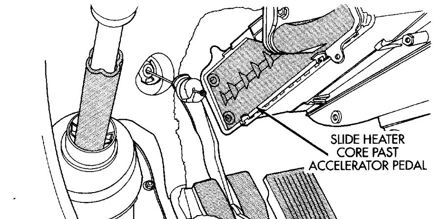

10. Pull up on accelerator pedal and slide heater core past.
Brake Pedal
imageZoom/Print
11. Depress brake pedal and remove heater core from HVAC housing.

For installation, reverse the above procedures. Install screws to retain heater core in housing. Replace heater core tube inlet O-rings. Tighten heater core tube retaining plate to 3 ± 1 NM (27 ± 9 in. lbs.) torque.
