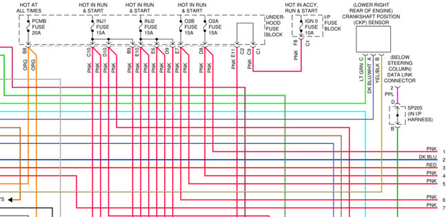

Please see below, I had to give the wiring information in sections.
At all O2 sensors pins C+D are for the heater control, so a 12V on the pink wire (pin D) and a switched ground from the PCM at pin C.
The 12V is supplied from O2A+O2B fuses in the under-hood fuse block, see image 3.

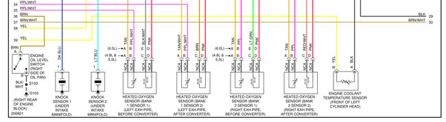

Bank 1.
Sensor 1 pin C, black/white wire to PCM pin 72 connector C2.
Sensor 2, brown wire to PCM pin 52 connector C2 .
Bank 2.
Sensor 1, light green wire to PCM pin 74 connector C2.
Sensor 2, red/white wire to PCM pin 53 connector C2.

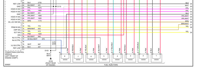

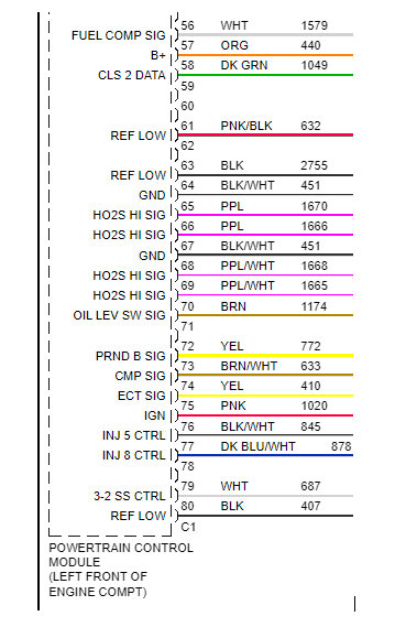

O2 sensor signal high is from pin B at each sensor to PCM connector C1.
Bank 1 have purple/white wires and bank 2 have purple wires.
See image 4.

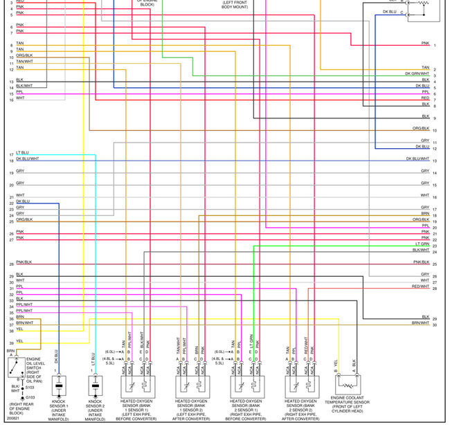

O2 sensor signal low is from pin A at each sensor to PCM connector C1.
Bank 1 has tan and tan/white wire, bank 2 only tan wires.
See image 5.
Suggest checking wiring from each O2 sensor connector to each pin at the PCM using a multimeter. Check the wiring for possible high resistance, short to positive or short to ground.
We should see no more than 5ohm (ideal less than 2ohm) resistance from pin to pin on each wire.

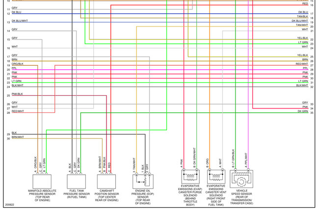

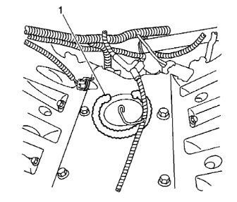

The CPS (Camshaft Position Sensor) has a 3-pin connector.
Pin A, brown/white wire to PCM pin 73 connector C1 Signal
Pin B, pink/black wire to PCM pin 61 connector C1 Low reference/ground
Pin C, red wire to PCM pin 39 connector C2 12V
See images 1+2 below.

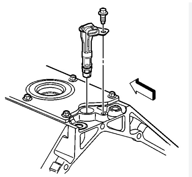

The sensor is located at the back of the engine.
See image 3.
