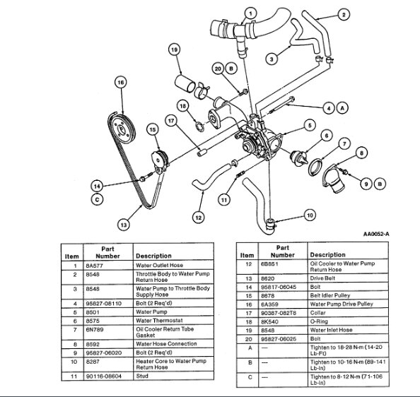

Coolant leak from behind pulley?

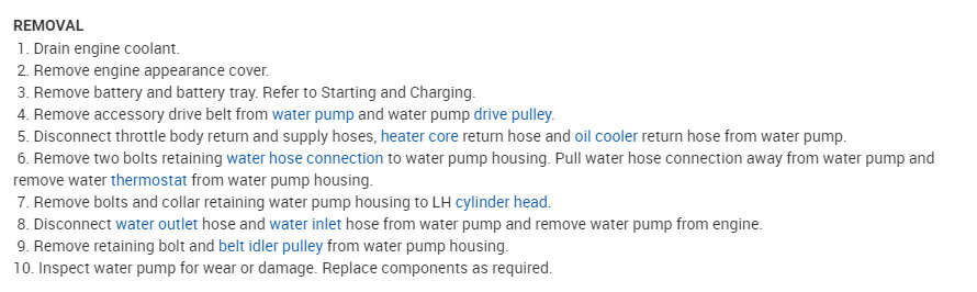

Checked all hoses and around water pump and not coming from either. The SHO engine has a weird water pump and belt located on the opposite side of pulleys and belts. Can anyone help?
Nov 22, 2022 at 10:34 AM
  • 110,248 POSTS

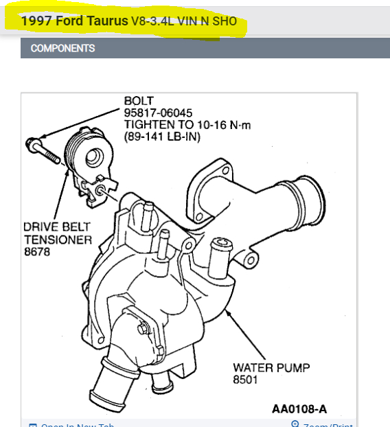

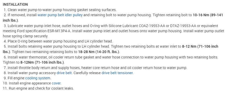

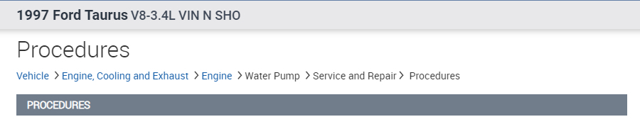

I attached the directions below for replacing the pump. If you are getting coolant from behind the pulley, chances are it is coming from the weep hole and the pump needs to be replaced.

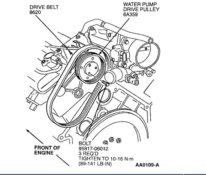

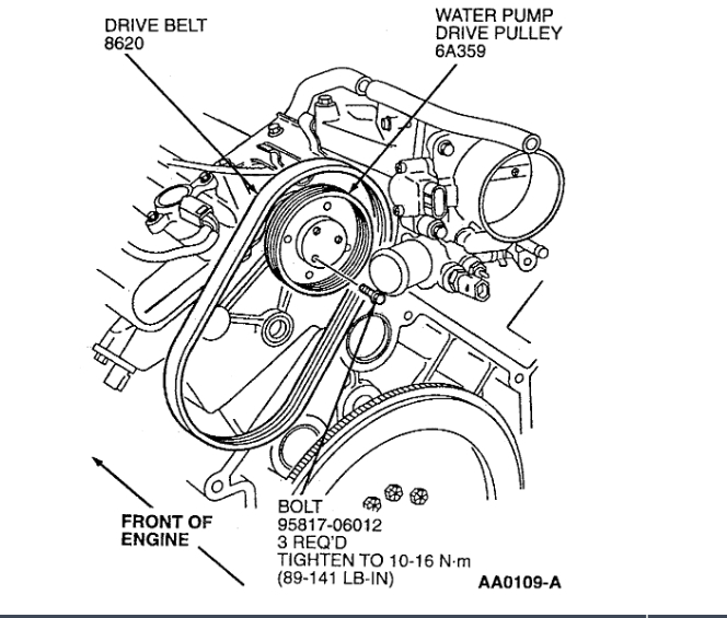

As far as the belt is concerned, it is absolutely in a strange place. It has a tensioner just like the serpentine belt at the front of the engine. I attached two pics below showing the tensioner and the belt. The tensioner turns the same as any tensioner. Once it's turned, you will be able to remove the belt. see the last two pics.
