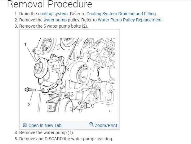

For two days there was a coolant leak coming from passenger side bottom corner, I can see vapor coming from beneath the headlight and a little puddle. The overflow tank was near empty. The last two days it seems to have stopped leaking as I didn't see any vapor coming from the bottom of the headlight and the coolant level hasn't dropped. I didn't use any stop leak product.

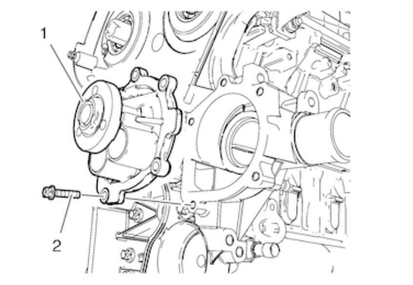

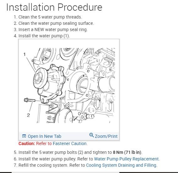

Had it pressure tested, turned out to be the water pump and S outlet located on left side next to cylinder head.
Apr 17, 2020 at 12:48 PM
Okay, I attached the procedure for you to replace the water pump below.
https://www.2carpros.com/articles/water-pump-replacement
Let me know if you have any other questions.
