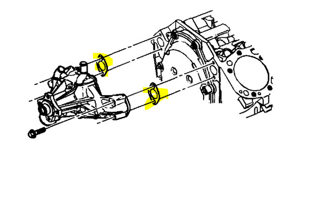

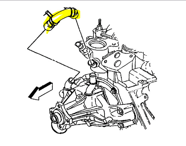

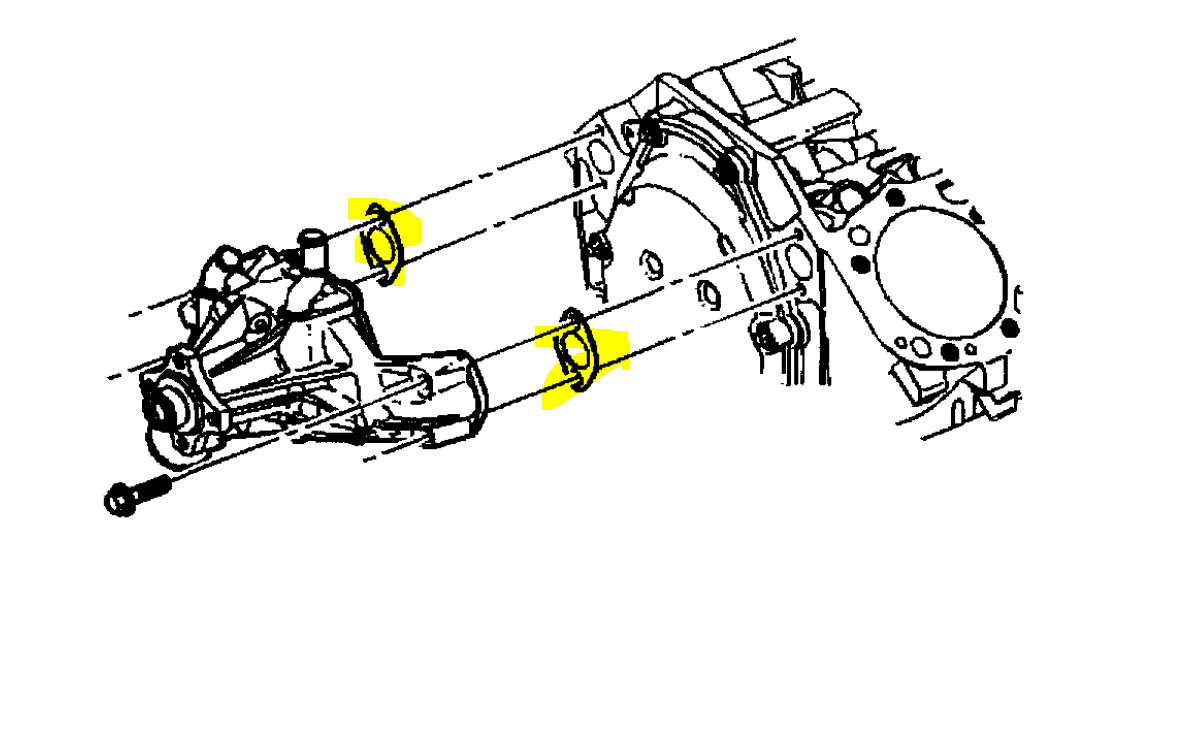

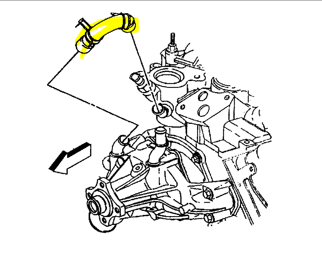

Overheated so we replaced the radiator and hoses to the radiator and thermostat. It was fine the first day but overheated the next and seems like it's leaking right behind the alternator. Have water running down the block between intake and valve cover on passenger's side. I can't find the source....

If it is near the alternator, my first suspect is the coolant bypass between the water pump and the intake.
I attached a pic below (Pic 1). Check that hose first. If it is good, check the two locations where the water pump attaches.
