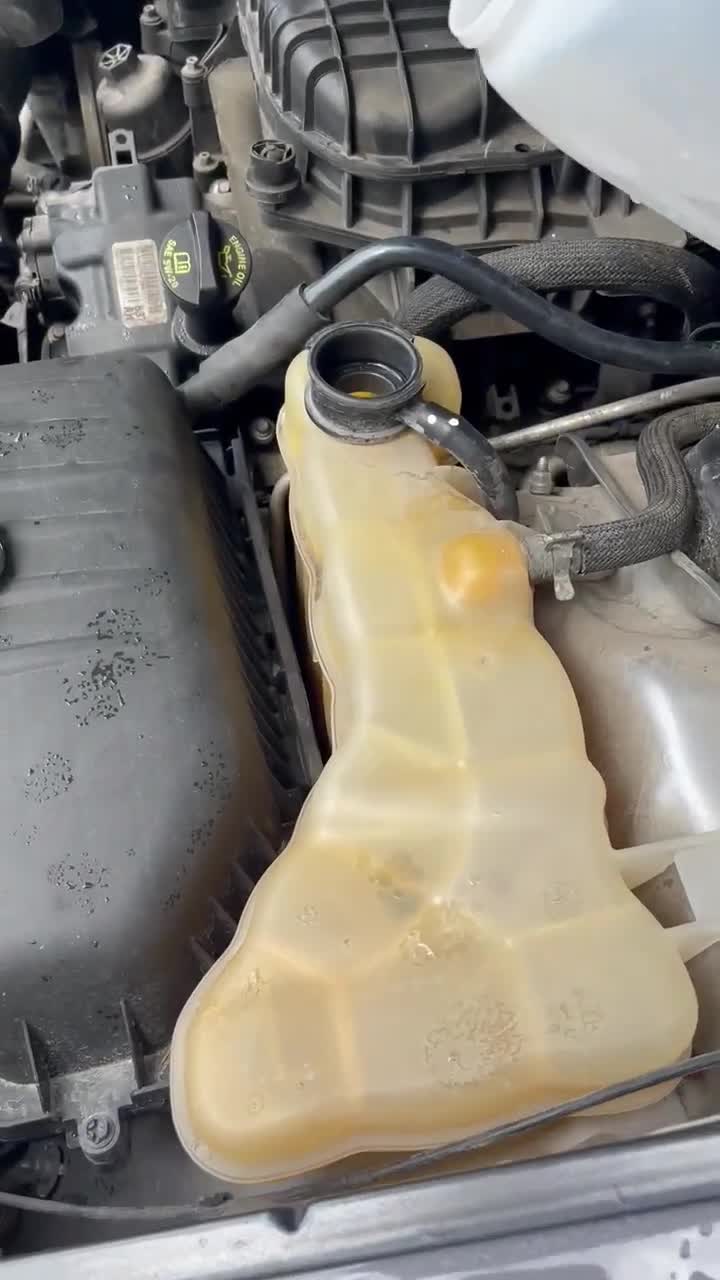

So, we were on our way back to Washington State from California, i was driving just past the California border into Oregon. It was a big hill... My car started struggling as it was weighed down, and then it was like the radiator blew out or a radiator hose. It got really hot really fast. It seemed to have no power or very little power. When I pour water in, and a few seconds later it starts coming out somewhere near the dash/back upper engine, but not in a place i can reach. Any advice on what the problem could be, I poured a whole gallon of water in and just as fast, it all came dripping out, looks like it is coming from (looking from the front end) the upper back of the engine. about 8-12 inches down and about 8-12 inches from the dash.

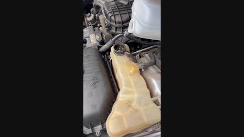

DANKYBATS
here is a video of the leak.

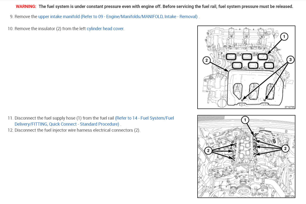

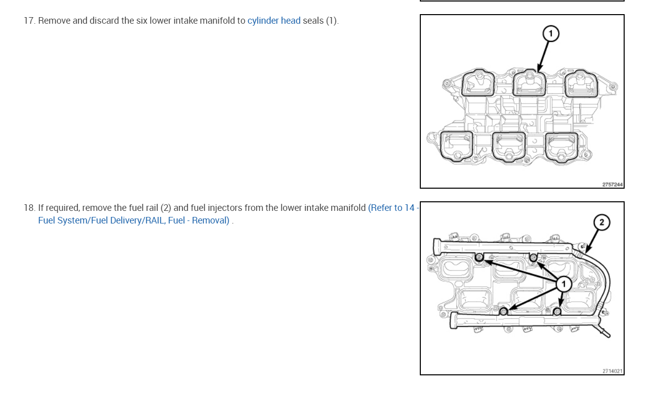

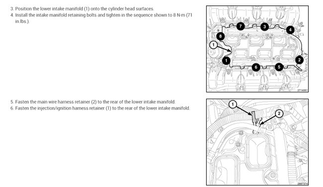

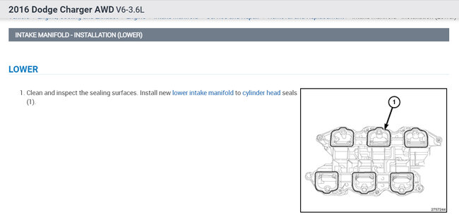

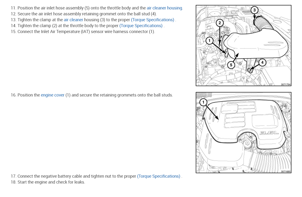

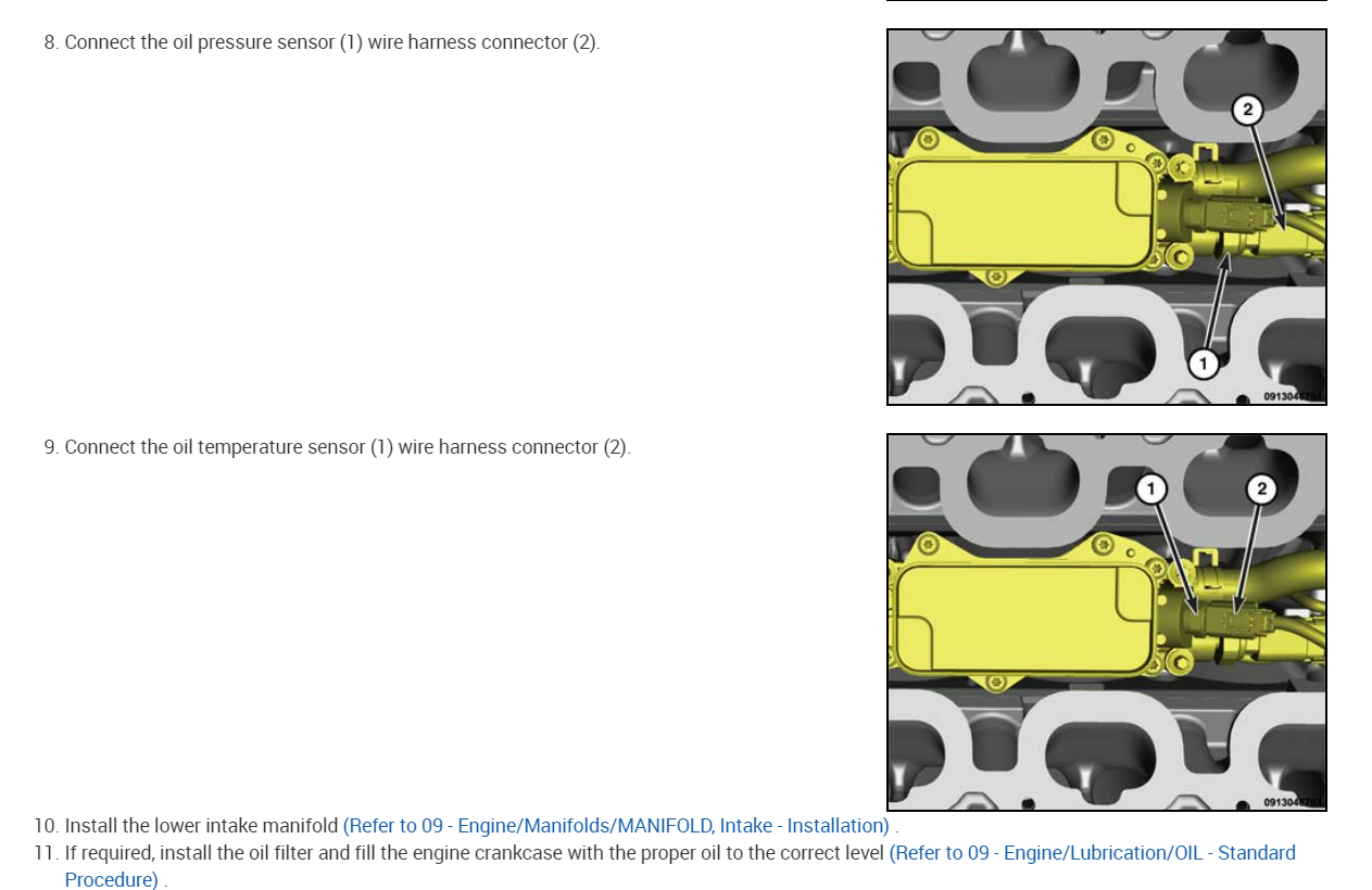

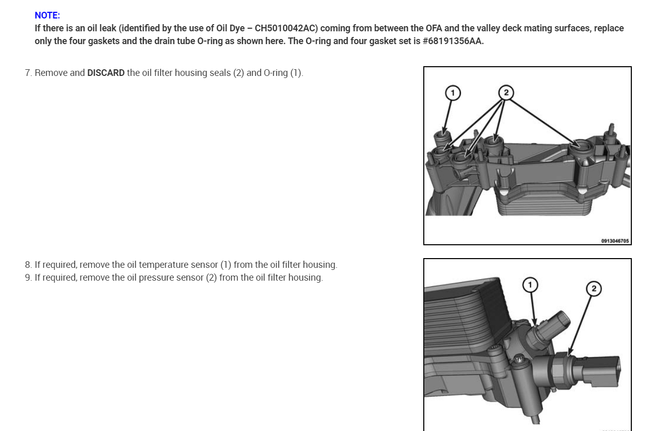

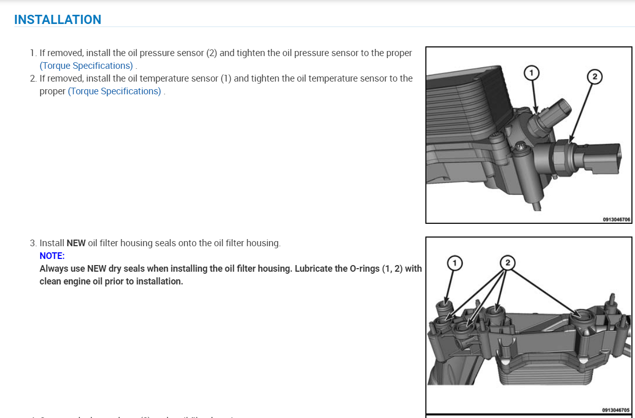

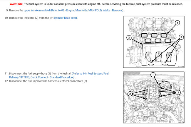

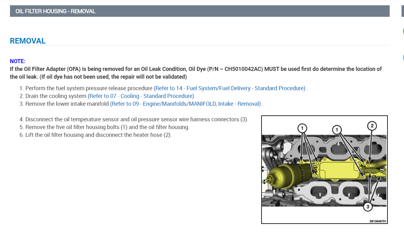

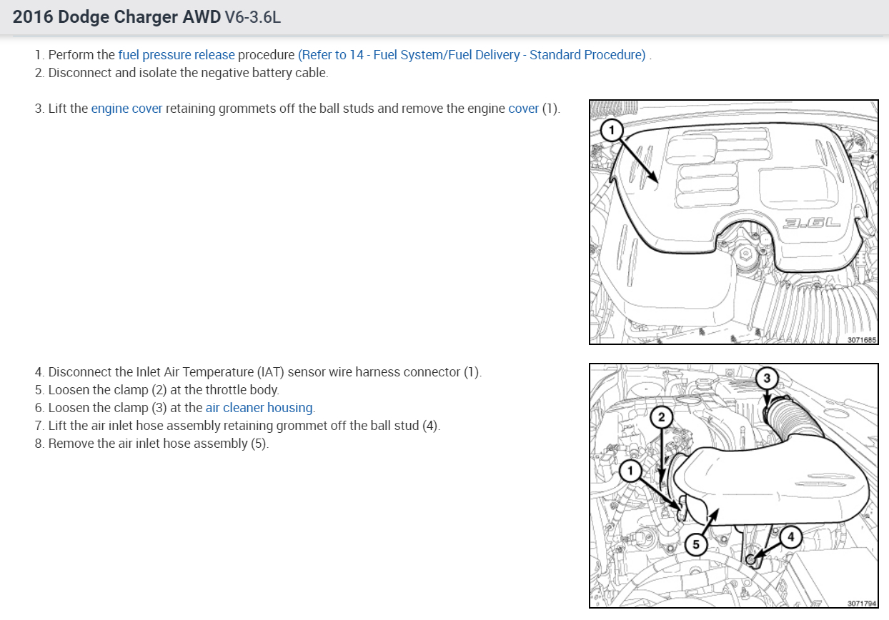

Thanks for the video. Please don't drive the car anymore or you could hurt the engine. I would like to see if you can remove parts to get a better look or use a mirror on a stick to get a better look. Check the images below so you can see what I am talking about.
https://amzn.to/433pn7Q
Let me know what you find.
May 16, 2023 at 5:22 AM

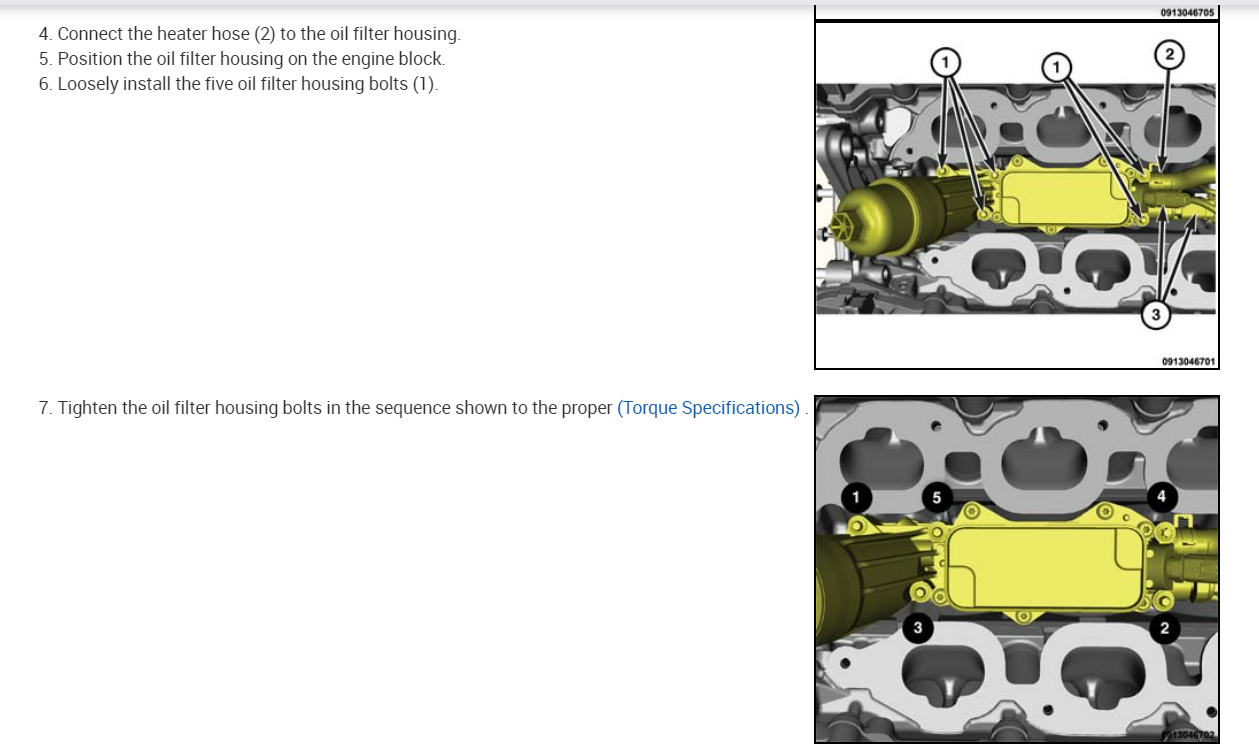

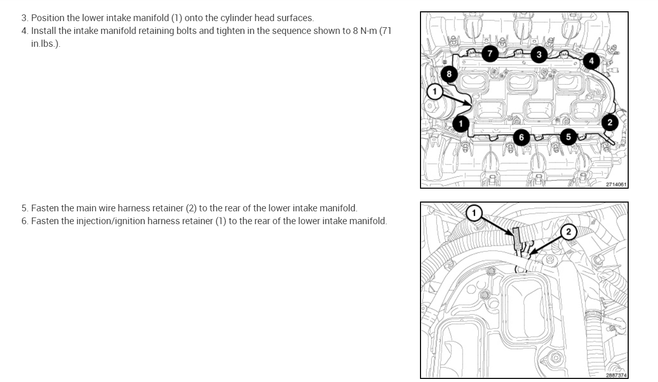

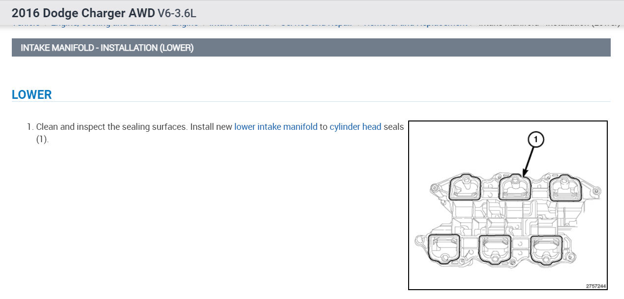

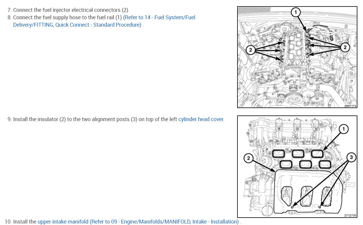

  • 55,402 POSTS
Okay, I did some research, and it seems these engines have an oil cooler under the intake manifold. I would remove the intake to replace the cooler, or the coolant hoses you should be able to see which one is leaking once the intake is removed. Thanks for the video.
